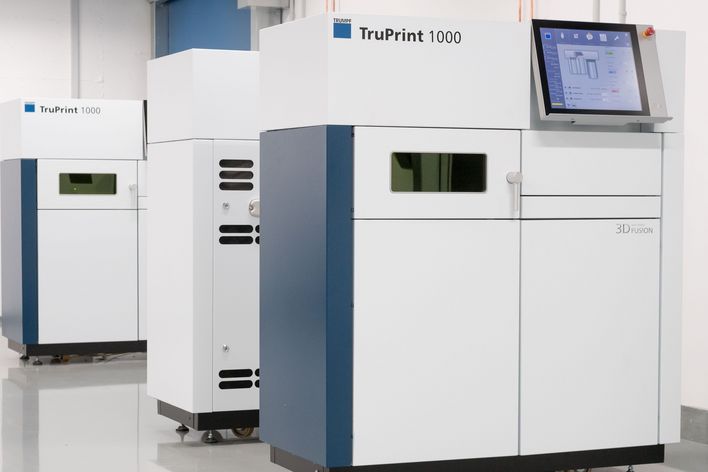

Just do it! Our TruPrint 1000 printer is an ideal entry-level model and is easy to install and operate. It is particularly suitable for small injection mold inserts such as those used for plastic connectors in the electronics industry. At TRUMPF, we also offer training in 3D design. We can supply the powder and parameters for each application directly, making it even easier for companies to adopt this new technology.
