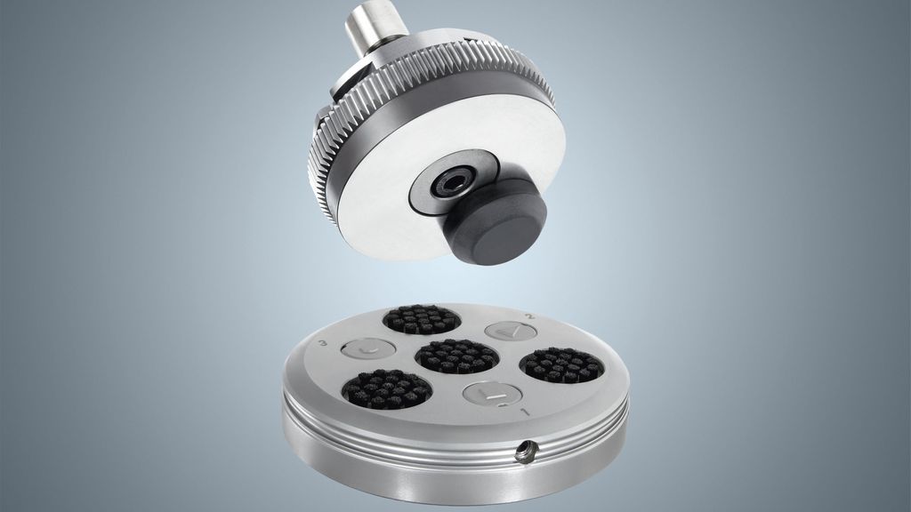

Using the ball deburring tool, you can deburr workpieces with a variety of geometries directly on your punching and punch laser machine. You benefit from high edge quality and reliable parts handling.
Faster production
Punching and deburring on one machine reduces throughput times.
Flexible
Deburr complex contours of different sizes with just one tool.
Deburring at the limits
The beveled punch head also enables deburring near to formed sections.
Long service life
Hardened ball rollers specially manufactured for TRUMPF increase the service time compared to the previous tool by up to five times.
Kugelentgratwerkzeug
By deburring sheet metal parts directly on your punch or punch laser machine, you can save yourself the subsequent and time-consuming removal of punching burrs. This means you can reduce the throughput time of parts considerably. The improved edge quality also reduces the risk of injury during further processing. The ball deburring tool is above all suited to smaller contours, holes, and corners in workpieces. During processing, the punching burr is pressed down, resulting in a chamfer on the top side of the sheet. Due to the beveled punch head, it is also possible to deburr close to formed sections.
