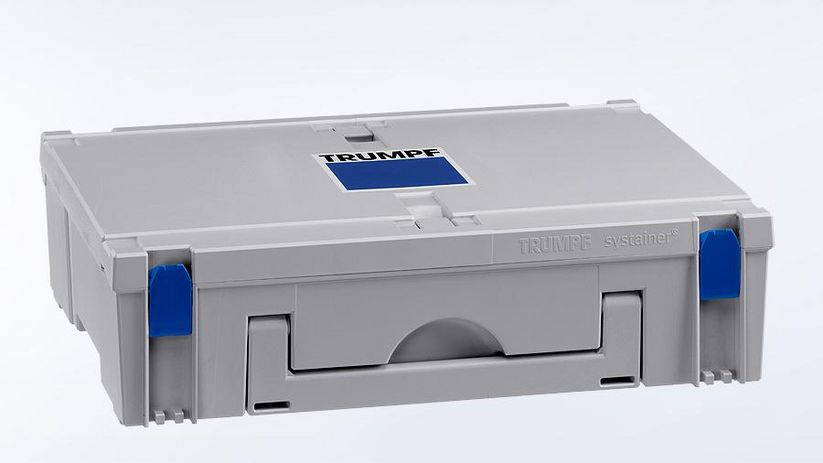

TRUMPF Box L2
TRUMPF Box L2
1 unti 1763686
