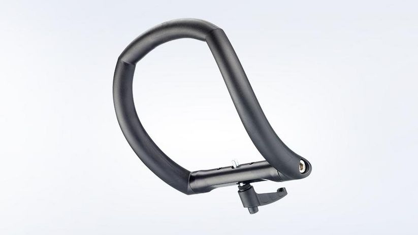

Two handles for custom work
The compact handle is ideal for processing profiles and working in restricted spaces. It is robust and heat-resistant. The bow-handle is well-suited to all work situations and allows you to choose a wide range of grip positions. Another benefit in its favor is the adjustable rotating motor handle which has been developed for applications where the machine is tilted by 90°.

TruTool N 700, Bügelgriff
Bow-handle
1 unit 1279590
TruTool N 700, Kompaktgriff
Compact handle
1 unit 1279618

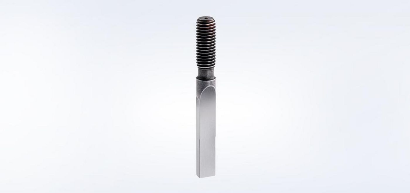

TruTool N 700, standard punch
Standard punch
For processing aluminum and mild steel
1 unit  2260200
Set of 2  1264117
Set of 5  1264119
TruTool N 700, punch CR
Punch CR
For processing stainless steel
1 unit  2260201
Set of 2  1264414
Set of 5  1264415

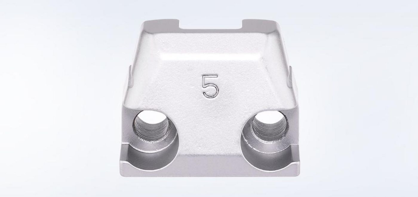

TruTool N 700, die No. 5
Die No. 5
For processing aluminum, mild steel, stainless steel 600 N/mm2 up to 5 mm, and stainless steel 800 N/mm2 up to 2.5 mm
1 unit  1884879
Set of 2  1264173
