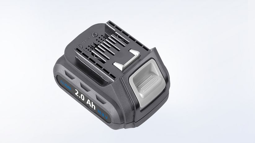

Individual electronic cell monitoring in the machine and in the charger protects the battery against overload, overheating, and deep discharge. The robust battery cells have a low energy drop and always remain cool. A microprocessor analyzes the battery data and controls an optimal charge and discharge process. The result is high power combined with a long service life for the battery. You can therefore work almost non-stop. The 2 Ah and 4 Ah rechargeable batteries only require 10 - 30 minutes to be charged to 80%.

Battery 2 Ah 18 V
2 Ah rechargeable battery 18 V (2 units)
1 unti 2272664
