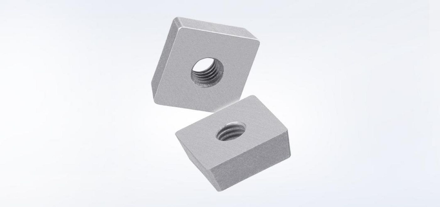

Top and bottom cutters have an identical shape and size. They also each have four cutting edges and can be easily interchanged with one another. It really is that simple: if the cutting performance decreases, rotate the cutter by 90° and you have a new cutting edge. This results in an above-average tool life.

TruTool S 250, cutter
Cutter
For steel up to 400 N/mm2
Set of 4  127911
Set of 10  1264341
