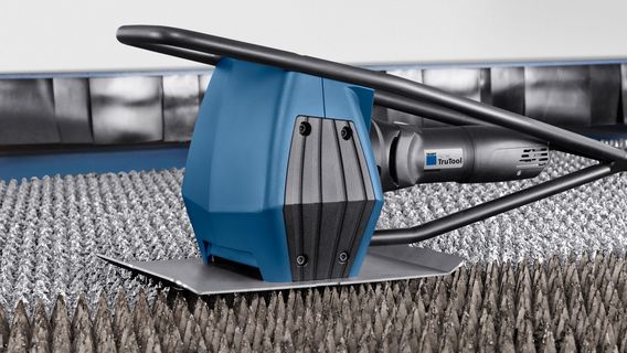

TruTool TSC 100
TruTool TSC 100
The TruTool TSC 100 is delivered together with the sorting and slat cleaning station.
