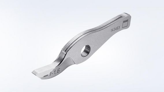

CR cutter, for optimal processing of stainless steel
Outstanding service life
We offer four different cutters to suit particular applications: the CR cutter is ideal for processing stainless steel. The curve cutter provides outstanding performance for cutting curves. There are two different cutters for straight cuts: one cutter for processing thin sheets of up to 1 mm and one for use on sheet thicknesses of 1 – 1.6 mm.

TruTool C 160, Messer 1 - 1,6 mm
Straight cutter (integrated)
1 - 1.6 mm

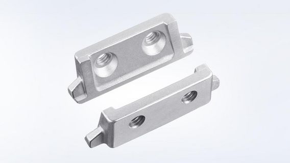

TruTool C 160, Schneidleistensatz
Cut guide set, 2 units with screws (integrated)
1 unit 0927708

TruTool C 160, cutter 1 - 1.6 mm
Straight cutter 1 - 1.6 mm
Ideal for sheet thicknesses of 1 - 1.6 mm.
Set of 2  1264343
Set of 5  1264345

TruTool C 160, cut guide set
Cut guide set
2 units with screws
Set of 1  927708
