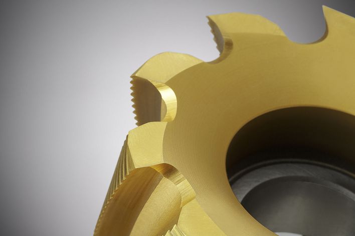

In particular, the TruPlasma Bias Series 3000 generators support the optical and metallic coating applications used in semiconductor technology or hard material coating, for example. They are also suitable for applications with comparable voltage and current requirements.

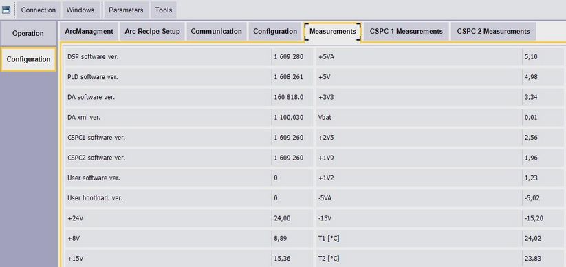

The user-friendly, multilingual PVD Power software offers you numerous operation, configuration and diagnosis options for optimising process quality and effective error correction: display of actual values for all relevant process parameters as well as warnings and alarms, specification of target values by the operator, as well as recording and visualisation of important operating parameters with high temporal resolution (oscilloscope function).
