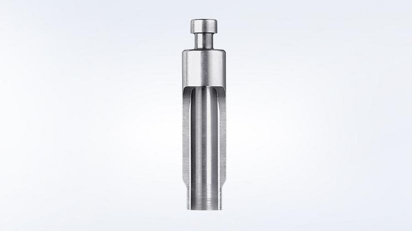

The hollow round punch provides excellent manoeuvrability
Lightweight and unrivalled performance on curves

TruTool N 200, Stempel
Punch (integrated)
1 unit 2260180
