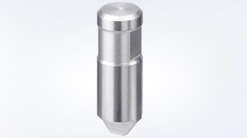

TruTool TF 350, punch
Punch
1 unit  1884902
Set of 2  1264160
