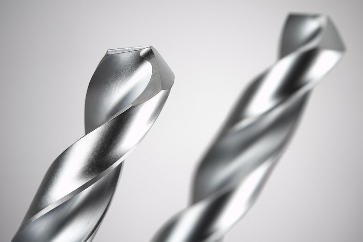

Hard material coating
The TruPlasma Arc Series 3000 generators are particularly impressive for hard material and decorative coatings.

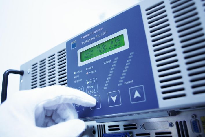

TruPlasma Arc 3200
TruPlasma Arc 3150
Output
Rated output 12 kW 9 kW
Maximum output current 200 A eff 150 A eff
Maximum output voltage 60 V eff 60 V eff
Ignition voltage
with auxiliary ignition 550 V 550 V
Network connection data
Line voltage 3x 360 V - 440 V 3x 360 V - 440 V
Line frequency 50 Hz - 60 Hz 50 Hz - 60 Hz
Communication interfaces
Analog/digital Yes Yes
RS 232 / RS 485 Yes Yes
PROFIBUS - Yes
EtherCAT No No
DeviceNet No No
Housing
Weight 35 kg 35 kg
IP protection class IP 20 IP 20
Cooling requirements
Coolant Air Air
Coolant temperature 5 °C - 35 °C 5 °C - 35 °C
General
Certificates / standards CE CE
Ambient conditions
Outside temperature 5 °C - 35 °C 5 °C - 35 °C
Humidity 5 % - 85 % 5 % - 85 %
Barometric pressure 860 kPa - 1060 kPa 860 kPa - 1060 kPa
