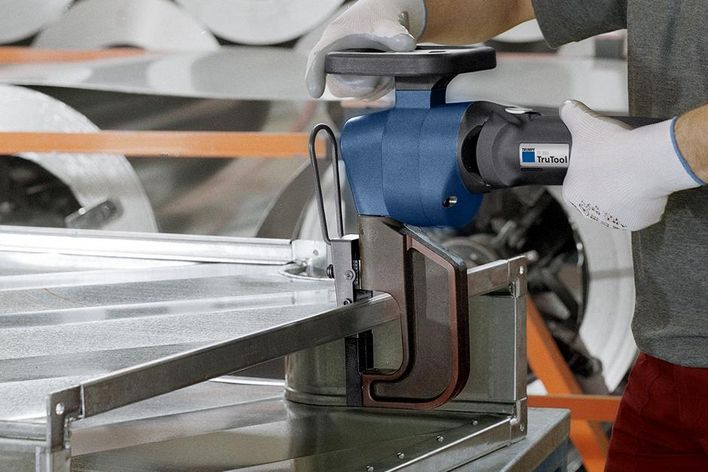

Joining is the simplest and most cost-effective way of connecting two or more metal parts. With the TruTool TF 350 you can produce a form-fitting material connection with joints that are easy to reproduce using cold forming. Whether the workpieces are coated or uncoated is irrelevant. The TruTool TF 350 joins overall material thicknesses of 0.8 mm to max. 4 mm. The result is a long-lasting connection in one operation, without additional connecting elements.
Straight to the point
The connection point is secure and resilient and the joining points are resistant to corrosion.
No fasteners
No screws or rivets are used, which saves costs and simplifies handling
Perfect surface in one operation
The joining quality does not depend on whether surfaces are coated or uncoated.
120 joining points per minute
Simple single stroke activation with consistent strength and connection quality.

Joining ducts
Joining ducts
Up to three parts can be connected together, even if the sheet thickness varies. For coated sheet metal, mild steel, stainless steel, aluminum, or with intermediate layers such as adhesive and plastic mats.

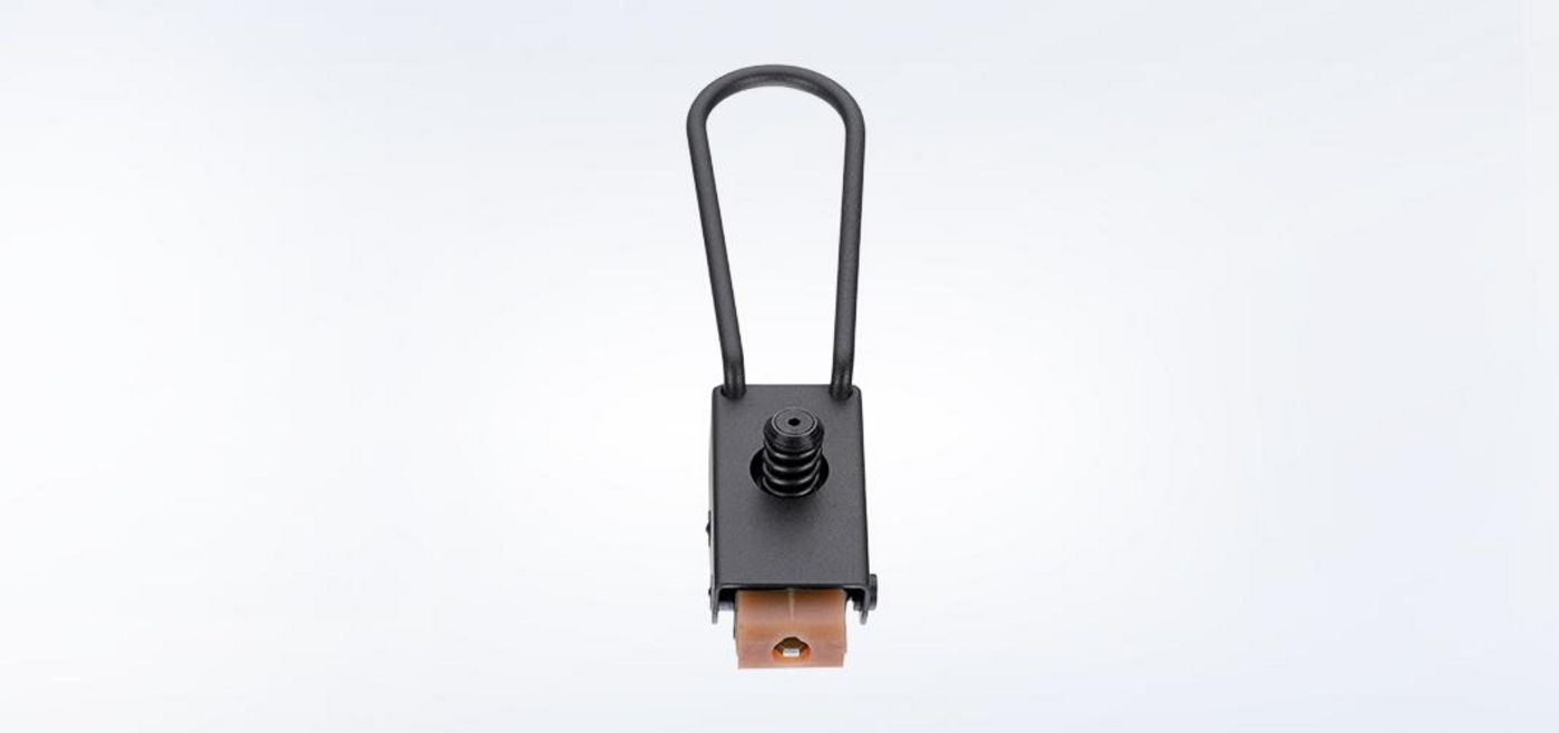

TruTool TF 350, Abstreifer für gerade Bleche
Stripper for straight sheets (integrated)
1 unit 0053649

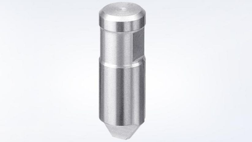

TruTool TF 350, punch
Punch
1 unit 1884902
Set of 2 1264160

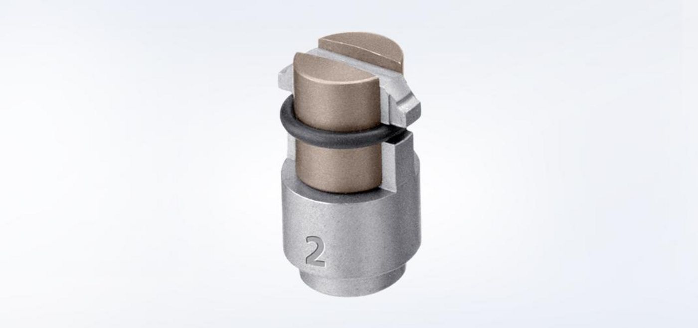

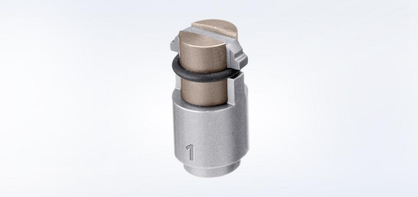

TruTool TF 350, die No. 1
Die No. 1
Well-suited for sheet thicknesses of 0.8 - 1.5 mm. You can choose between five different dies depending on the material thicknesses: 1, 2, 2+, 3- or 3.
1 unit 111969

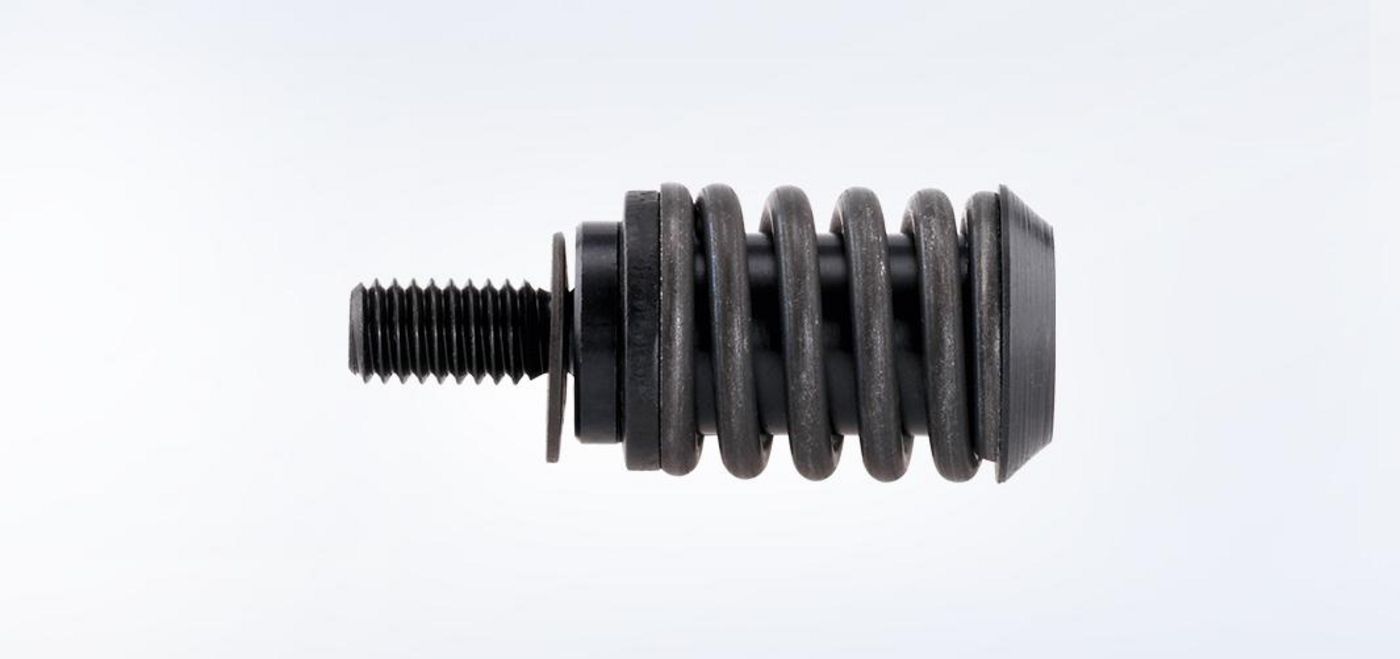

TruTool TF 350, disc spring
Disc spring
1 unit 30678

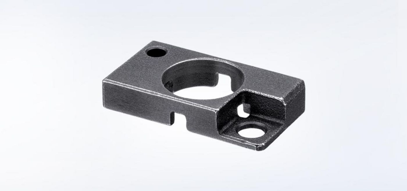

TruTool TF 350, plate
Plate
1 unit 1884876

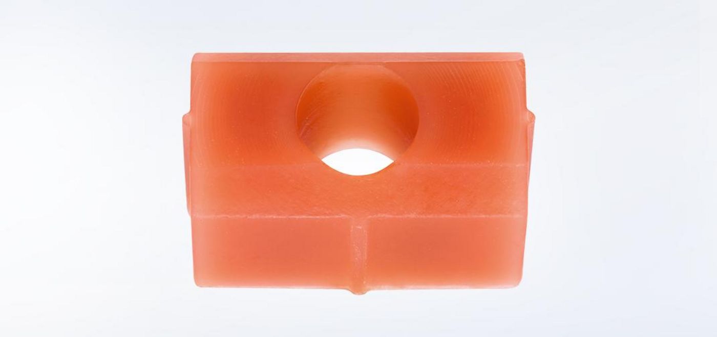

TruTool TF 350, plate for channels
Plate for channels
1 unit 243189

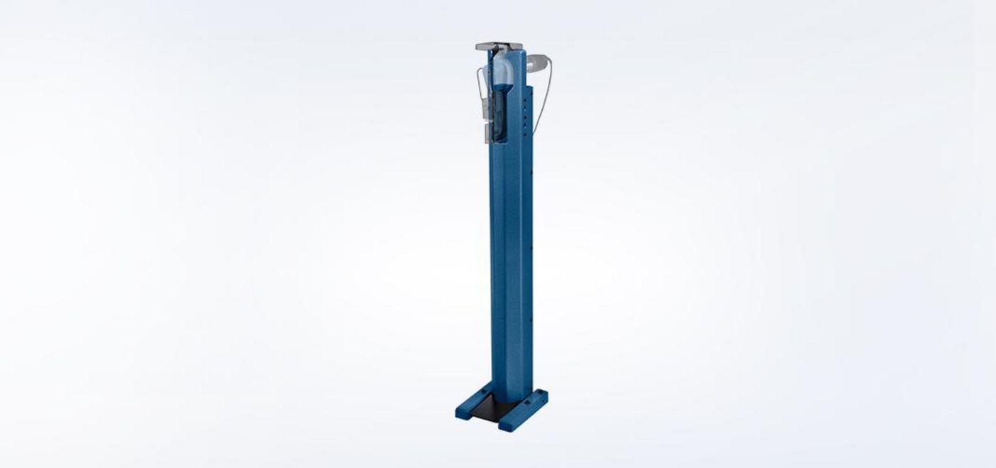

TruTool TF 350, joining station
Joining station
For quick and easy joining together of smaller sheet parts. Well-suited for stationary use.
1 unit 1224803

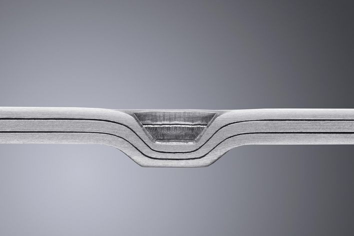

With the clinching process, the sheets of metal to be joined are placed on top of each other. Then the tool cuts a strip into the sheets in a combined punching and forming process. A form-fitting and corrosion-resistant connection joins the top and lower sheets as the materials flow into one another. The connection point solidifies resulting in a permanent connection without additional tools or heat.
TruTool TF 350, flat joint
No fasteners
The rectangular joining point appears as a shallow raised spot. This means that you have no interference contour, such as in the case of edges that you find with screws and rivets. The simple handling means no fasteners are required and the machine is quickly ready for use. The TruTool TF 350 can also be adapted to the desired application quickly and easily. Simply choose the relevant tool.

The joining zone is not exposed to thermal load or tension. The protective layer flows with the material during forming. This means that the material properties are unchanged, remain free of oxidation, and the surface structure is not damaged. There is no need for preliminary work or rework. An additional benefit is that clinching avoids material surface contamination. This is perfect for coated and uncoated materials; even sheet metal with a layer of oil is ideally suited to this.
