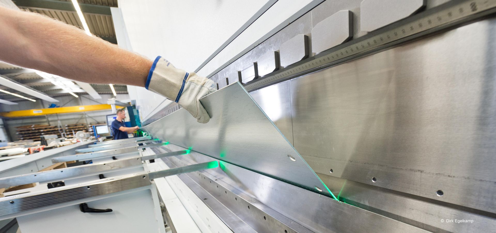

And that wasn’t the only custom feature. The VarioPress 400 at Schrag also has a higher-power motor and an additional H-axis. “We can also bend Z profiles. But when you’re dealing with a profile that has already been bent down one way, you need to adjust the support brackets before you can bend it again. You can either do that manually or by having the brackets positioned in a height-adjustable axis at the front. With the latter solution we can simply use the machine’s control system to move the brackets down automatically, and that’s obviously a major benefit,” says Kleinau.

Typical order volumes at Schrag range from a single item up to batches weighing 20 tons. As well as top-quality, most customers also require very short turnaround times. The VarioPress 400 at Schrag has a higher-power motor and an additional height-adjustable axis that allows users to bend Z profiles.

One highlight of the 400-ton press brake that everyone appreciates is the flexible tool system. “A key requirement for industrial buildings is that you don’t want water on the outer shell to drip onto a cut edge. Otherwise you get corrosion infiltrating the metal,” Kleinau explains. That’s why Schrag folds the edges over, which requires at least two different lower tool slots. They bend the sheet 45 degrees, fold it, bend it another 45 degrees and fold it again. And even then it still requires another 90-degree bend to produce a corner angle. “It simply wouldn’t work without lower tool displacement. That’s why it’s standard on all our machines,” says Kleinau.
