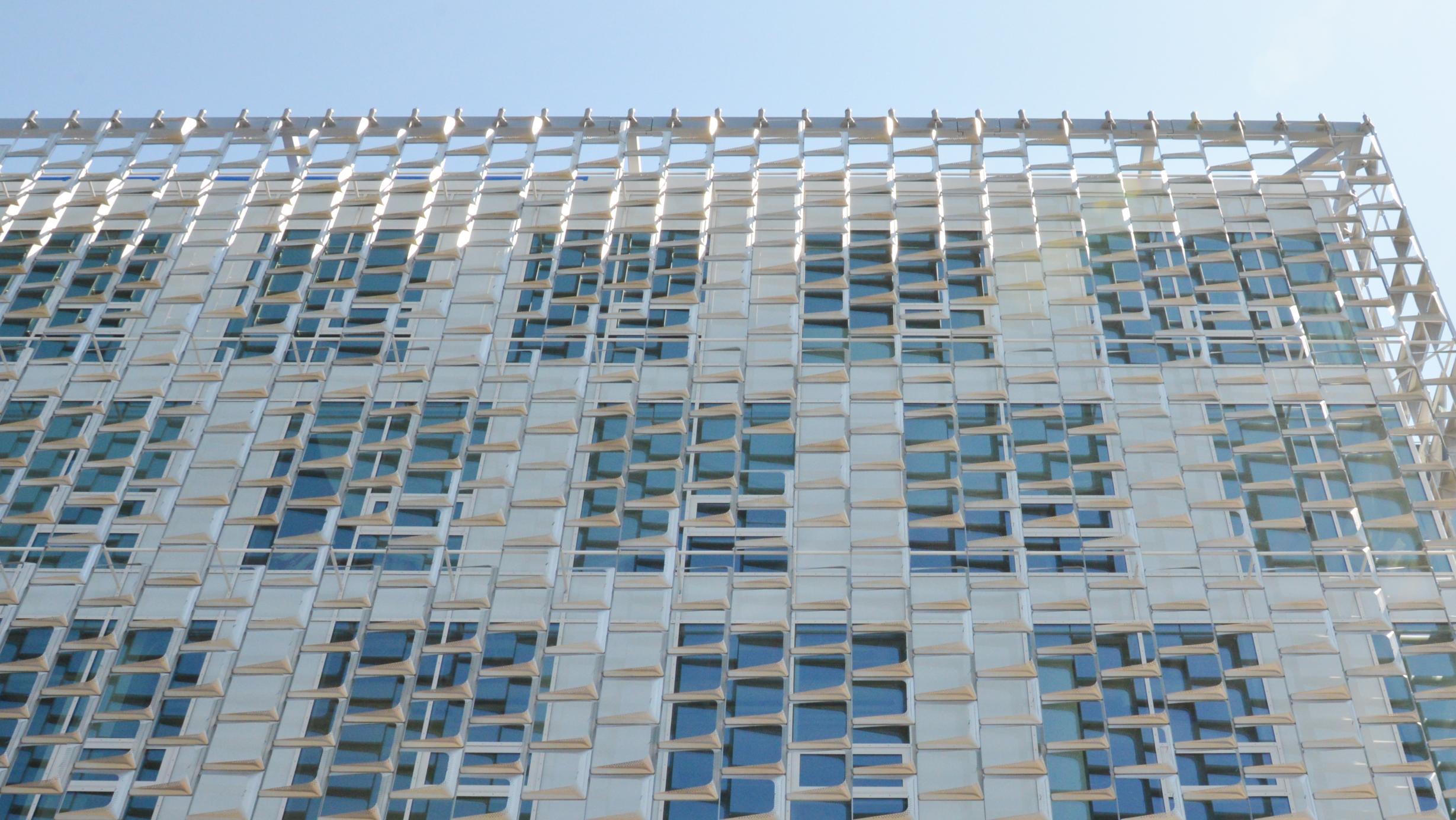

Binder Parametric Metal GmbH has also experienced the challenge of gaining acceptance in the market, as sales director Christian Geiger explains: “Talking to architects, we’ve noticed that many of them still haven’t fully taken on board the benefits of making a decorative facade out of metal: it’s easy to assemble, completely recyclable, very robust, economical and can be adapted to whatever shape is required.” The company, which is headquartered in the Bavarian town of Karlskron, has carved itself a niche in 3D metal facades –and the laser is the per - fect tool for cladding buildings in new forms. Precision is the key when it comes to free-form surfaces, whether they are fabricated for the facades of parking garages or for decorating the inte - rior of all sorts of other buildings in a truly unique way. “For a good facade, you need the edge to be perfectly precise all the way around, even when it passes through three-dimensional forms,” says Geiger. A laser has no trouble achieving this kind of precision whatever the shape, and it is equally serene in the face of small batch sizes and time pressure –two challenges that facade builders often have to deal with.
Parkhaus in Bietigheim-Bissingen. (Quelle: TRUMPF)
Multistory parking garage in Bietigheim-Bissingen (Source: TRUMPF)
