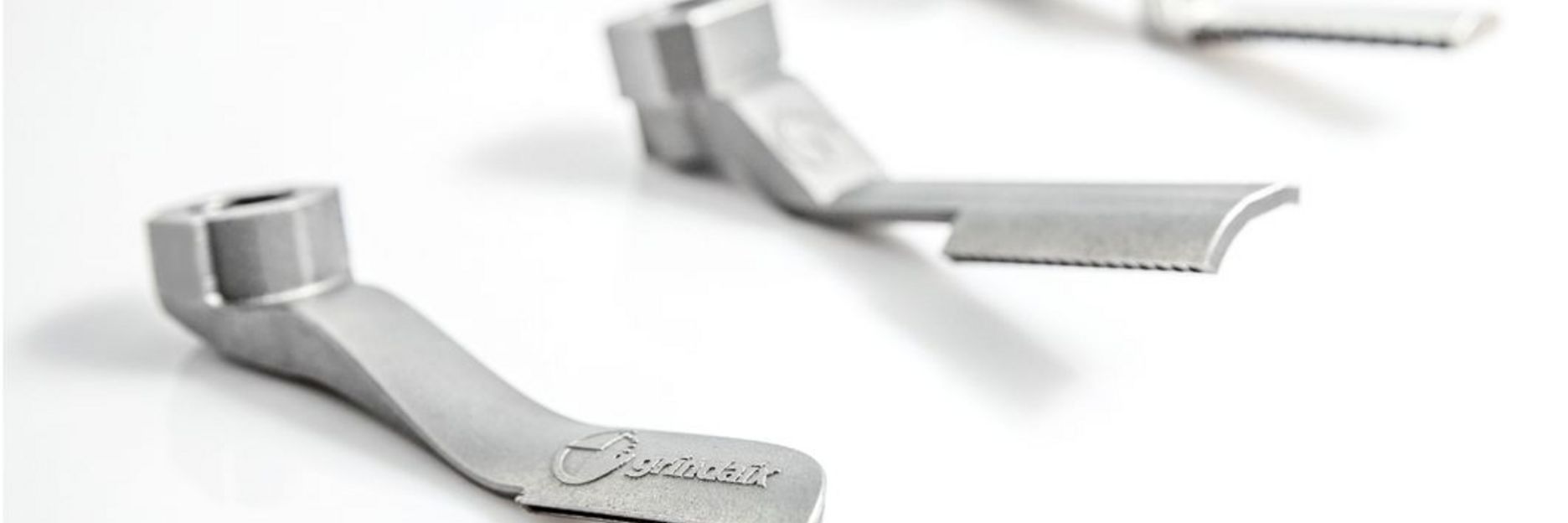

Equally important is the ability to recognize the limitations of the 3D printing process and sidestep them where possible. “In 3D printing we hold the part in position on the 3D printer platform using supports, which have to be removed once the process is finished. But in many cases you can avoid using supports completely by designing the part in a certain way,” says Schmidt-Lehr.
To design a part for 3D printing, the first step is to model all the essential aspects, in this case the defined lubricoolant entry and exit points and the space required to avoid collisions with moving machine parts. The designer then adds only as much material as is absolutely necessary for the part to fulfill its purpose. “Machine cost per hour is still a key cost driver in 3D printing. The smaller a part’s volume, the shorter the process time required to construct it. By leaving out any material that is unnecessary we make the part lighter, and that’s often a major advantage in its own right. But even if it doesn’t matter how heavy the part is, reducing the volume still makes it cheaper to produce,” says Schmidt-Lehr.
Unlike conventional methods, the designer can focus purely on optimizing how the part works. In the case of Grindaix coolant nozzles, curved channels lead to a lower drop in pressure thanks to reduced flow losses. That reduces the amount of pumping power required, so the end customer benefits either from the ability to use a smaller pump or from a higher coolant exit velocity.

All one piece: Redesigned by Bionic Production, this nozzle offers gentle curves straight from the 3D printer. Picture: Claus Langer
