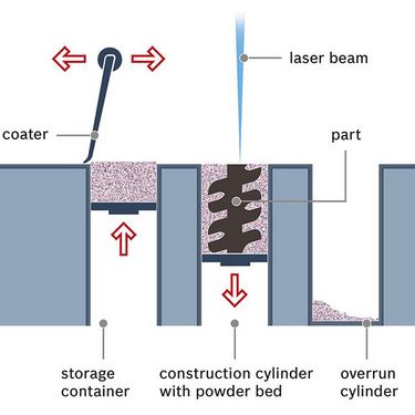

The Technique
The so-called “coater” applies powder from the storage container to the construction cylinder. Then a laser melts the first layer of powder according to the part contour. After this, the construction cylinder drops. This process is repeated until the component is complete. Each time the coater returns to the storage cylinder, it cleverly tilts in order to reverse quickly without colliding with the powder bed or the constructed component. To ensure component quality, the entire process in the chamber takes place under protective gas.
