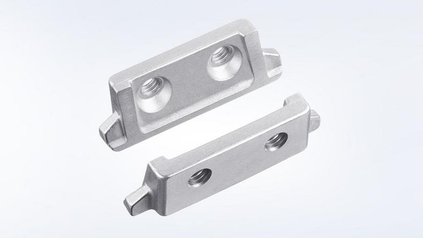

TruTool C 160, Schneidleistensatz
Cutting strip set, 2 units with screws (integrated)

TruTool C 160, cutting strip set
Cutting strip set
2 units with screws
Set of 1  927708
