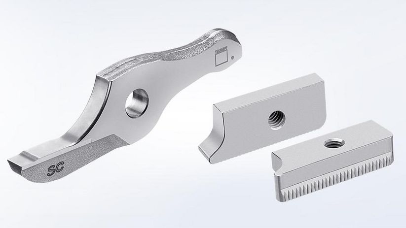

TruTool C 200 Set Spiro
Set Spiro (fitted)
1x SC cutter, 2x toothed cutting blade
Set Spiro
Set of 1  2328882

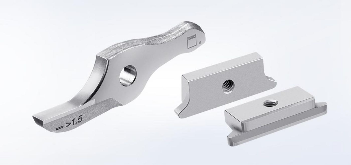

TruTool C 200 Set HighQuality
Set HighQuality
1x straight cutter, 2x cutting blade
Set of 1  2328883

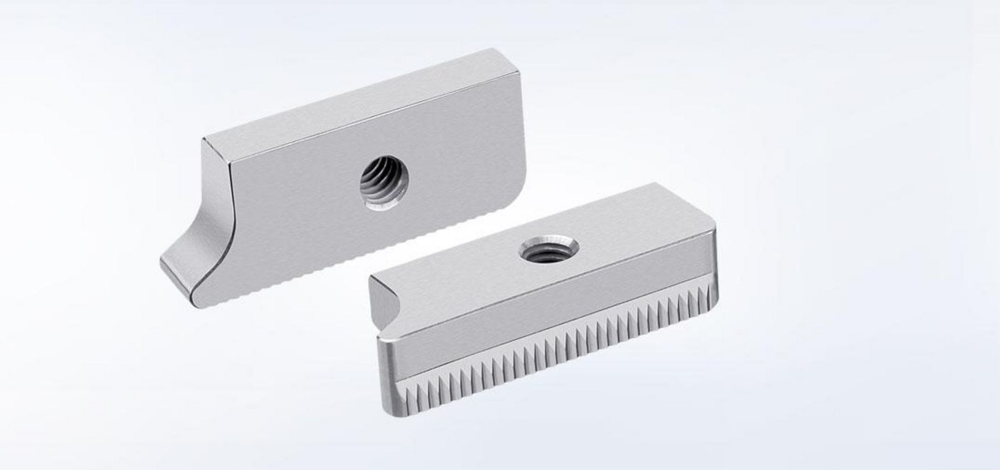

TruTool C 200 Set HighSpeed
Set HighSpeed
1x cutter, 2x toothed cutting blade
Set of 1  2328884

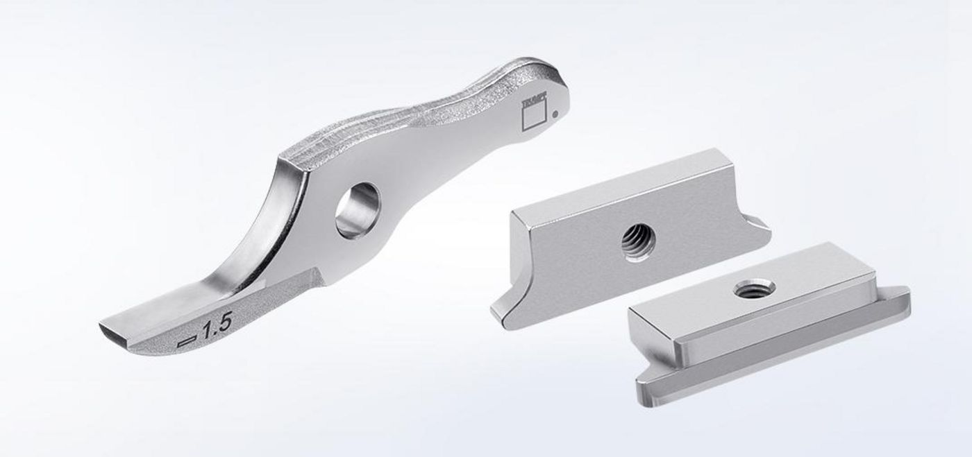

TruTool C 200 Set ThinSheet
Set ThinSheet
Set of 1  2328885

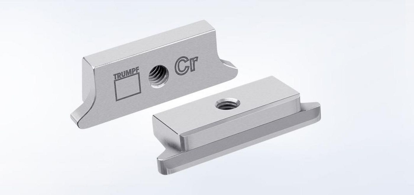

TruTool C 200 Set SC
Set CR
1x CR cutter, 2x CR cutting blade
Set of 1  2328886
TruTool C 250, cutter SC
Cutter SC
Ideal for spiral ducts up to 4 x 0.035 in.
Set of 2  1279109
Set of 5  1279110

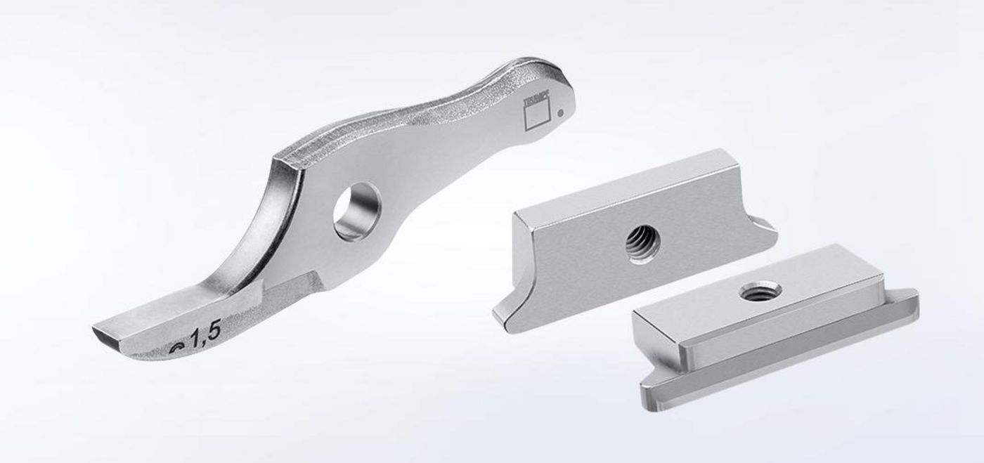

TruTool C 250, Messer Gerade 0,5 - 1,5 mm
Straight cutter 1.5 - 2 m
Ideal for sheet thicknesses 1.5 mm - 2 mm
Set of 2  2365673
Set of 5  2365674

TruTool C 200
Standard cutting blade 1.5-2 mm
Set of 1  2332028

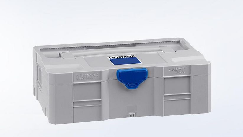

TRUMPF Box M2
TRUMPF Box M2
1 unit  1770890

With the TruTool C 200, both the cutters and the cutting blades are adapted to the respective application. The toothed cutting blade achieves an automatic feed and reduces the feed force. This results in exceptionally high working speeds and simple processing of double sheets. With the standard cutting blade, the cutting quality takes precedence over the cutting speed. The CR cutting blade is used to process stainless steel. We offer the different cutting blades with matching cutters in six sets: Set Spiro, Set HighQuality or HighSpeed up to 2 mm, Set ThinSheet up to 1.5 mm, and the Set Curves and Set CR.
