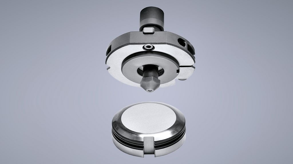

Save time and effort: Using the marking tool from below, you can mark your sheets from underneath without having to turn them, directly on your punching or punch laser machine.
Reduce the time required
Time savings due to the direct marking from below without needing to additionally turn the sheet over
Low-scratch and practically mark-free
The surface of the sheet remains almost unaffected on both sides.
Quiet and free of vibration
Together with the active die, vibration is avoided and the noise level is reduced.
A balancing effect
When processing sheets with fluctuating thicknesses, the combination with the calibration tool yields perfect results.
Signieren von unten
Due to the direct marking from below, there is no need to turn or post-process the sheet, saving you valuable time. You can mark the sheet bottom side completely flexibly with letters, numbers, symbols or any contours. A marking pin in the die of the tool marks the sheet bottom side through the active die stroke. As it is only the marking pin which comes into contact with the underside of the sheet, it is protected against scratches. The marking tool therefore prevents vibration in the sheet and reduces the noise level during processing. A plastic ball roller in the punch acts as a gentle counterholder, thereby minimizing imprints on the sheet top side. If the calibration tool is also used, modification of the adjustment values at the machine is no longer needed for varying sheet thicknesses.
