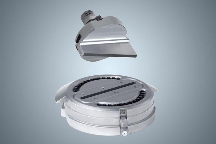

Due to patented cutting technology, with the MultiShear slitting tool for punching or punch laser machines, you can achieve mark-free separating cuts with no troublesome nibbling marks.
Edges with laser quality
The MultiShear creates mark-free outer and inner contours.
Low part costs
Increased productivity due to high cutting speeds of up to 12 m/min
Long service life
Due to specially coated cutting blades
Highest surface quality
Brush inserts in the die guarantee low-scratch processing.
Cutting close to formed sections
With the optionally available stepped stripper, cutting close to formed sections is also possible.
MultiShear
During the cutting of parts with standard punching tools, unwanted nibbling marks on the visible edge are created. The MultiShear tool creates mark-free cutting edges in excellent quality, therefore saving you reworking. The MultiShear tool is used for outer and inner contours, as well as for common cuts.
The high cutting speed of 12 m/min which is achieved when using the MultiShear, results in lower part costs. Brush inserts in the die guarantee low-scratch processing. During the movement process, the sheet glides on the brushes so that there is no direct contact between the sheet and the die. The brush inserts also reduce the punching noise. A stepped stripper is also available for cutting near formed sections.
