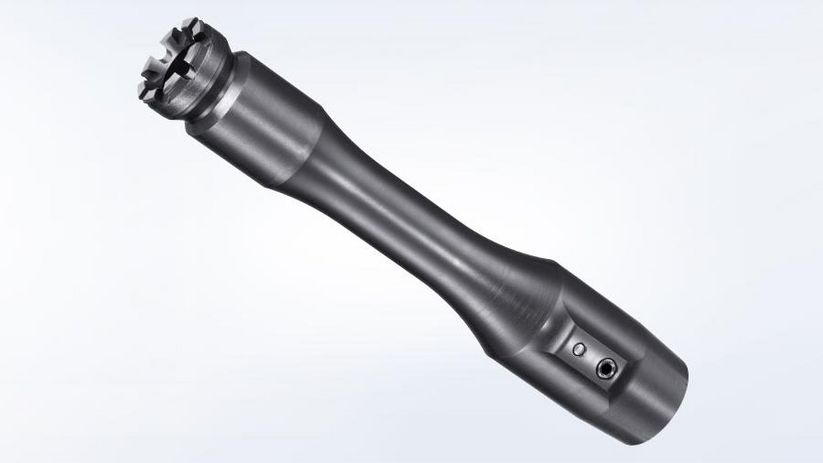

TruTool N 160, extension
Extension
1 unti 2507897

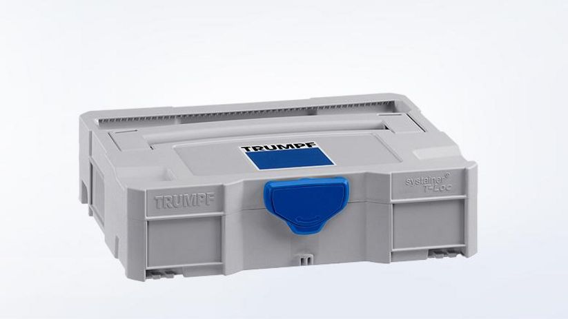

TruTool N 160, TRUMPF Box S1
TRUMPF Box S1
1 unti 1763681
Extension
For deeper profile sheets

TRUMPF Box S1
1 unit  1763681
