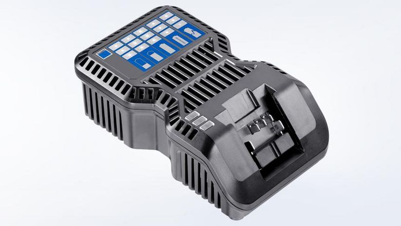

Battery technology
Individual electronic cell monitoring in the machine and in the charger protects the battery against overload, overheating, and deep discharge. The robust battery cells have a low energy drop and always remain cool. A microprocessor analyzes the battery data and controls an optimal charge and discharge process. The result is high power combined with a long service life for the battery. You can therefore work almost non-stop. The 2 Ah and 4 Ah rechargeable batteries only require 10 - 30 minutes to be charged to 80%.

Charger 18 V
Charger 100 - 240 V incl. cable
1 unti 2272666

Charger 18 V
Recharger LG 18V / 10.8V
For Li-ion rechargeable battery 18 V with 2 Ah, 4 Ah, or 5 Ah. Cable included.
1 unit (USA)  2275872
1 unit (DE / CH)  2272666
1 unit (GB)  2275871
