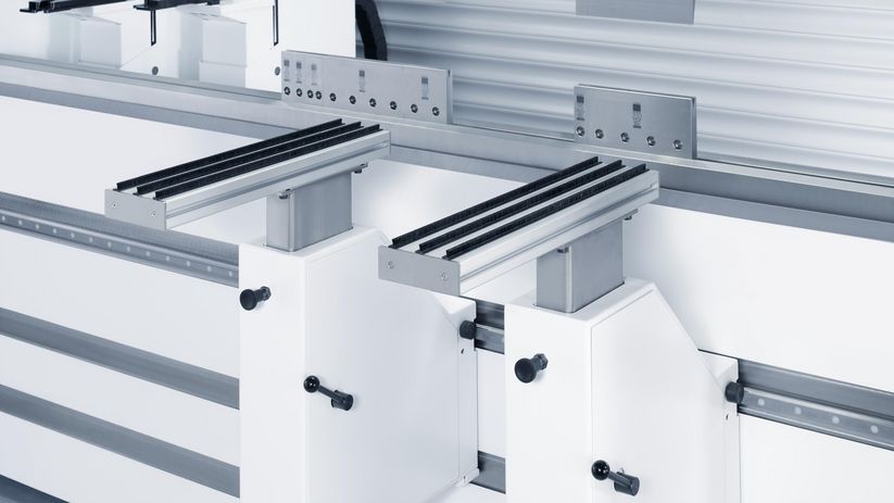

Height adjustable support brackets make component handling easier. The robust support brackets each have a load capacity of 660 lbs. and are available with different supports.
The practical bending aid including automatic height adjustment provides valuable help – in particular when bending heavy or large parts. It has a load capacity of up to 660 lbs.

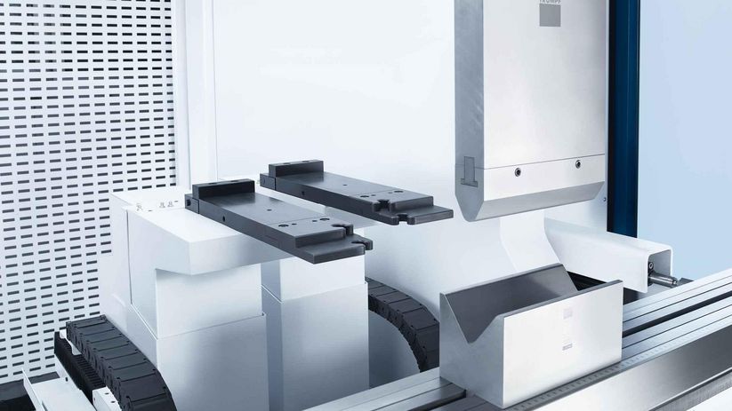

With the lower tool displacement you can perform two different bending operations with one tool. This increases part variety while saving setup time and investment costs. The lower tool displacement also enables special applications, such as folding.

ToolShuttle, the practical tool magazine, stands directly next to your TruBend Series 8000 machine. During setup, tools are simply slid in and out of the machine, something that is particularly useful for heavy tools, saving time. The ToolShuttle has space for nearly 200 feet of tools and ensures everything is organized.
