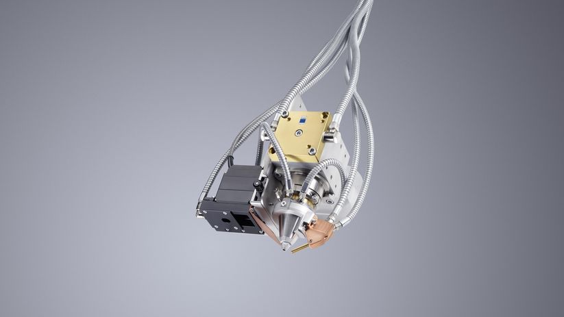

BEO D70 focusing optics with observation camera, crossjet, and aerator nozzle
BEO D70
Large working distances with small focal diameters – the BEO D70.
