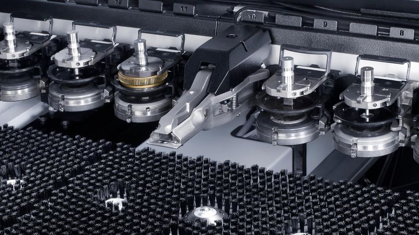

TruPunch 2000, linear magazine
Linear magazine
The linear magazine, which is integrated in the coordinate guide, guarantees fast and simple tool setup.

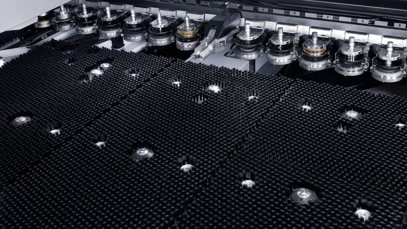

TruPunch 2000, brush table
Table equipment
Brush tables are available for gentle material handling.
