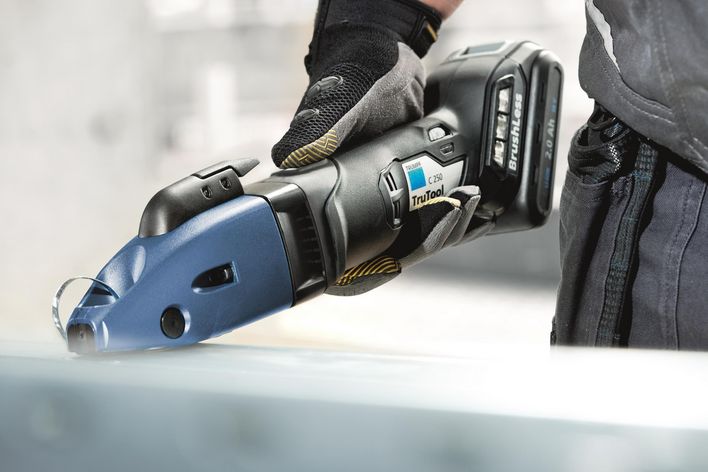

Perfect for cutting spiral ducts
The most powerful cordless slitting shears
The TruTool C 250 Li-ion rechargeable battery 18 V machines are the first slitting shears with rechargeable battery, which cordlessly cut sheet thicknesses of 2.5 mm in mild steel and 1.5 mm in stainless steel. You can cut chips single-handed at any time and pull the machine out of the workpiece with the integrated chip clipper that can be operated by one hand. Excellent for notching work and interior cutouts. The 18 V battery provides an above-average runtime. For example, with the 2 Ah rechargeable battery you can therefore cut up to 50 meters in mild steel and a sheet thickness of 1.5 mm.
Chip clipper for single-handed operation
Chips can be easily cut with one hand at the touch of a button. Perfect for interior cutouts and notches.

For comfortable operation
A soft grip ensures low-vibration machine control. The machine is thereby extremely compact and light.

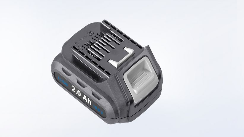

Individual electronic cell monitoring in the machine and in the charger protects the battery against overload, overheating, and deep discharge. The robust battery cells have a low energy drop and always remain cool. A microprocessor analyzes the battery data and controls an optimal charge and discharge process. The result is high power combined with a long service life for the battery. You can therefore work almost non-stop. The 2 Ah and 4 Ah rechargeable batteries only require 10 - 30 minutes to be charged to 80%.

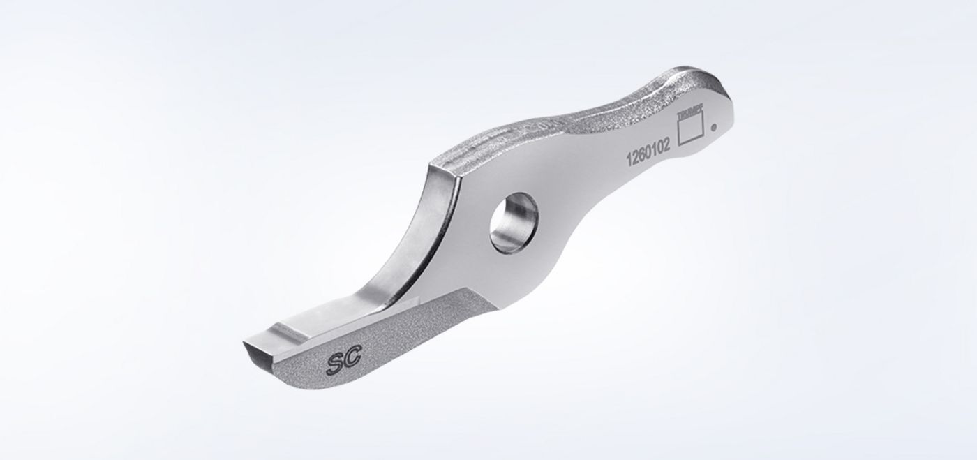

We offer 5 different cutters: The CR cutter is ideal for processing stainless steel. The curve cutter cuts with excellent contouring. The spiral cutter is ideal for spiral ducts and cuts even sheet thicknesses of up to 0.14 in. quickly. There are two different cutters available for straight cuts: One cutter for processing thin sheets of up to 1.5 mm and one further cutter for use on sheet thicknesses of 1.5 – 2.5 mm

For cutting spiral ducts. For sheet thicknesses of 4 x 0.9 mm or 6 x 0.6 mm in mild steel, and 4 x 0.6 mm in stainless steel.

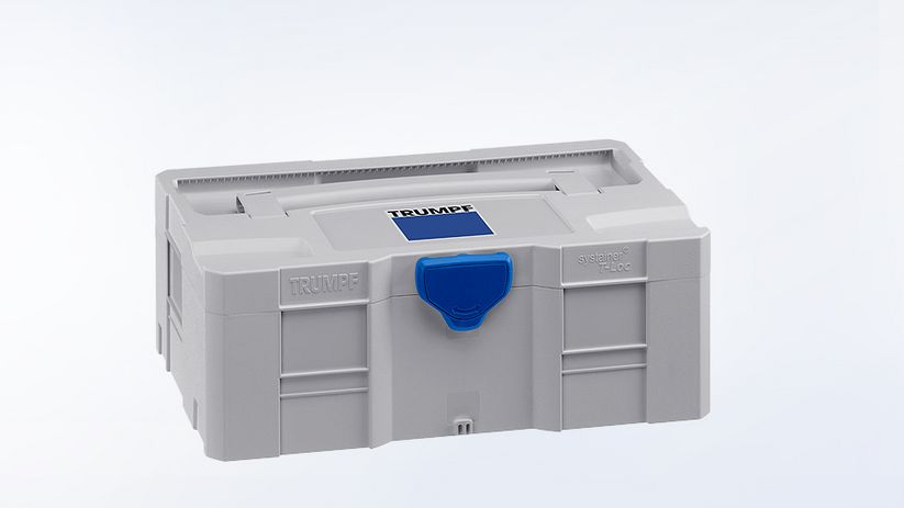

TRUMPF Box M2
TRUMPF Box M2
1 unit

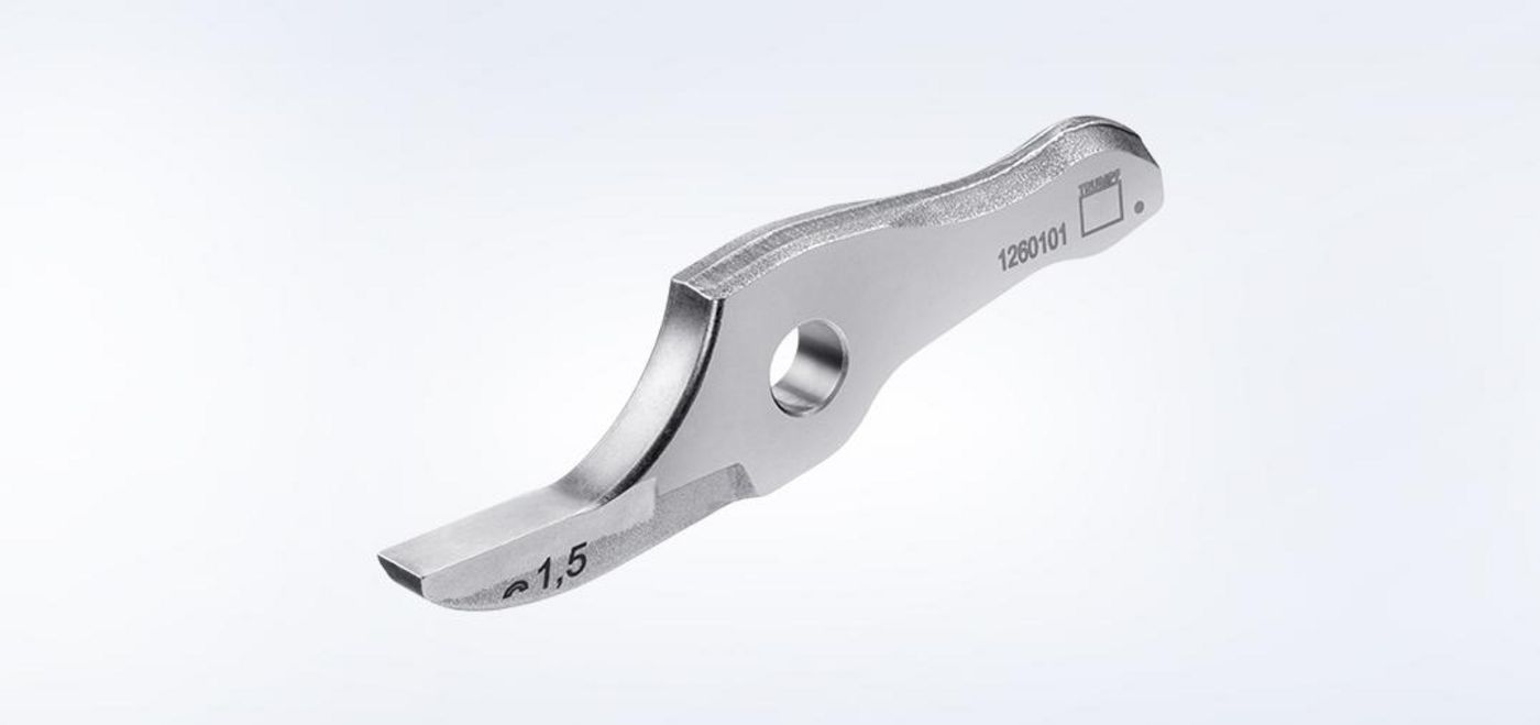

TruTool C 250, straight cutter 1.5 - 2.5 mm
Straight cutter 1.5 - 2.5 mm
Ideal for sheet thicknesses 1.5 - 2.5 mm
Set of 2 1279105
Set of 5 1279106

TruTool C 250, cutter SC
Cutter SC
Ideal for spiral ducts up to 4 x 0.035 in.
Set of 2 1279109
Set of 5 1279110

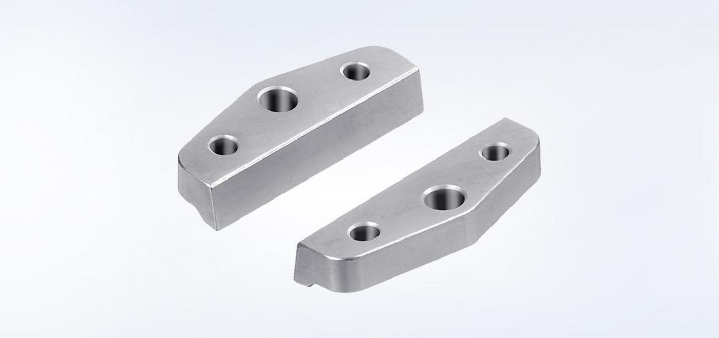

TruTool C 250, cutting strip set
Cutting strip set
2 units with screws
Set of 1 1275275

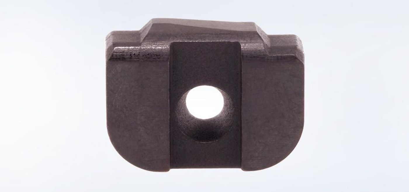

TruTool C 250, cutter plate
Cutter plate
1 unit 1267770

Battery 2 Ah 18 V
Li-ion rechargeable battery 18 V, 2 Ah
1 unit 2272664
Battery 4 Ah 18 V
Li-ion rechargeable battery 18 V, 4 Ah
1 unit 2272665

TRUMPF Box M2
TRUMPF Box M2
1 unit 1770890
