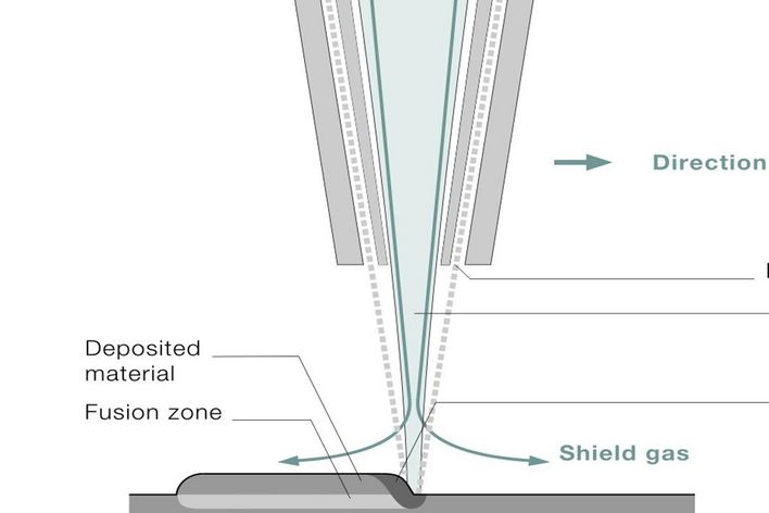

The process of laser deposition welding is fairly simple using TRUMPF's DepositionLine: You use the laser to generate a molten bath on the prepared surface. Powdered material is guided through the nozzle, step by step. Once the new material has cooled, you weld the next layer, or start the refinishing process.
TRUMPF DepositionLine
TRUMPF's DepositionLine consists of three major functional units: the powder conveyor, the powder conveyor line, and the processing optic with powder nozzle.
The powder conveyor is a mobile unit directly next to the laser processing machine. The powder/gas mixture from the individual containers is combined in the powder conveyor to form a powder mass stream, and fed to the powder nozzle as a precisely regulated flow.
