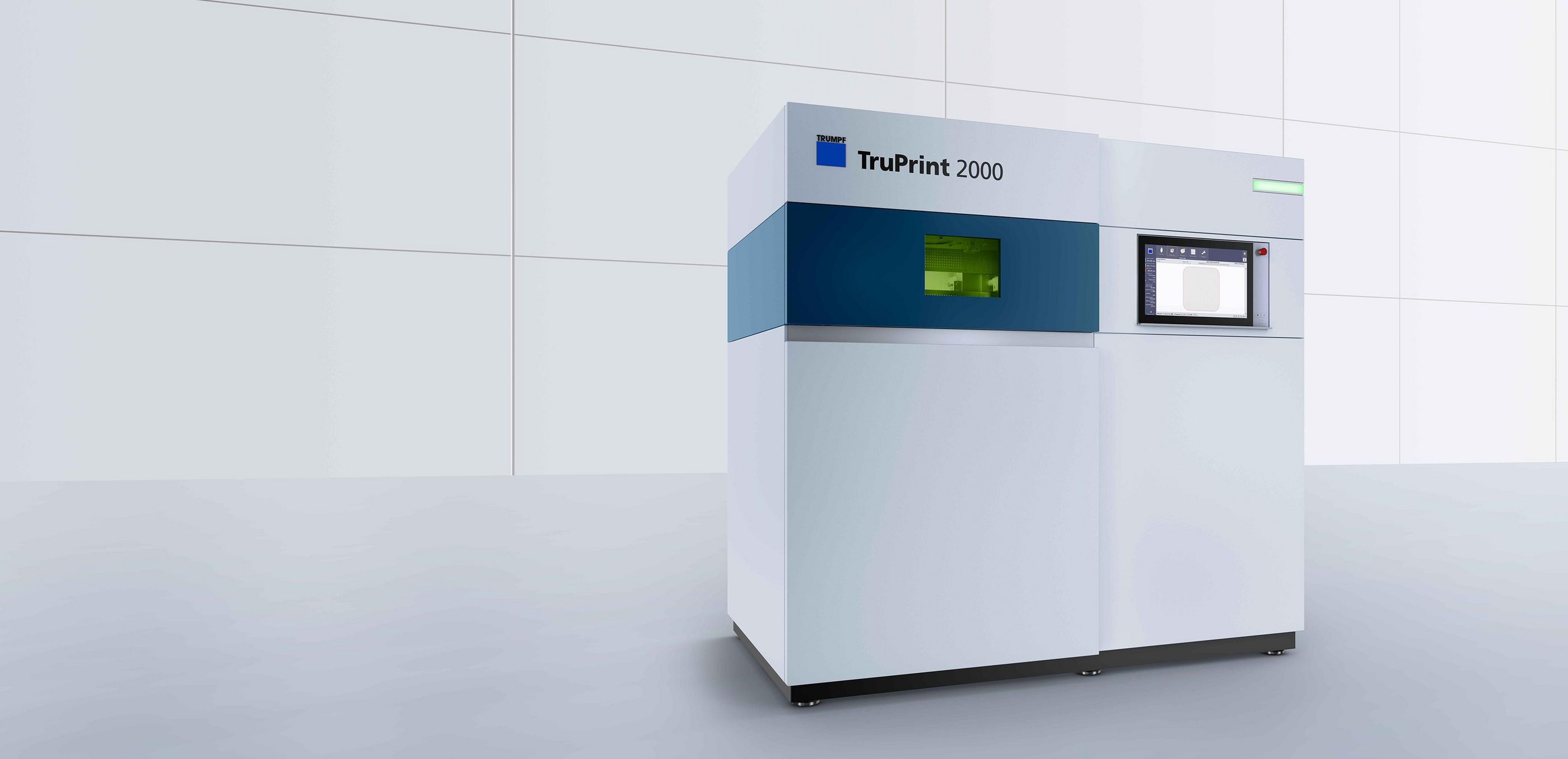

The TruPrint 2000 stands for the highest quality, robust processes and high productivity. With a build volume of 200 x 200 mm base and a height of 200 mm, it offers the perfect solution. Thanks to the extended build volume and the new basic spot configuration with 80 µm, the TruPrint 2000 is the perfect system for the tool industry as well as for applications in the dental, medical or general industry.
For example, up to 36% more RPDs (Removable Partial Dentures) can be placed on the square build plate than on a round build plate with a diameter of 200 mm. With the 80 µm spot full-field multilaser, users also benefit from our new dental parameters, which allow them to print up to 30 RPDs in around 4 hours.
Easy nesting
Thanks to the square base and building board fastening on the underside, components can be easily arranged - right into the corners.
Highly productive printing in premium quality
The 500 W laser power and the 80 µm beam diameter with the multilaser option deliver excellent, highly productive results.
Lower part costs
The combination of build volume, laser power and recoating time results in an economical machine concept for your series production.
More possibilities
With the adjustable spot diameter (55/80 µm) and detailed process analysis, you benefit from a high level of process flexibility and extended monitoring.
Easy to use
Benefit from the simple and safe handling of powder and parts thanks to an inert, closed powder circuit.
Discover all TruPrint 2000 functions in our product animation
A square fits better
The TruPrint 2000 offers you design freedom in a 200 x 200 x 200 mm build volume. The optimized optical structure enables high quality even in the corners of the building board - and without any annoying screws on the building board.
In the dental industry, 36% more RPDs can be fit onto the same plate compared to a round plate. Tool and mold making also benefits from the increased machine surface area and laser power.
