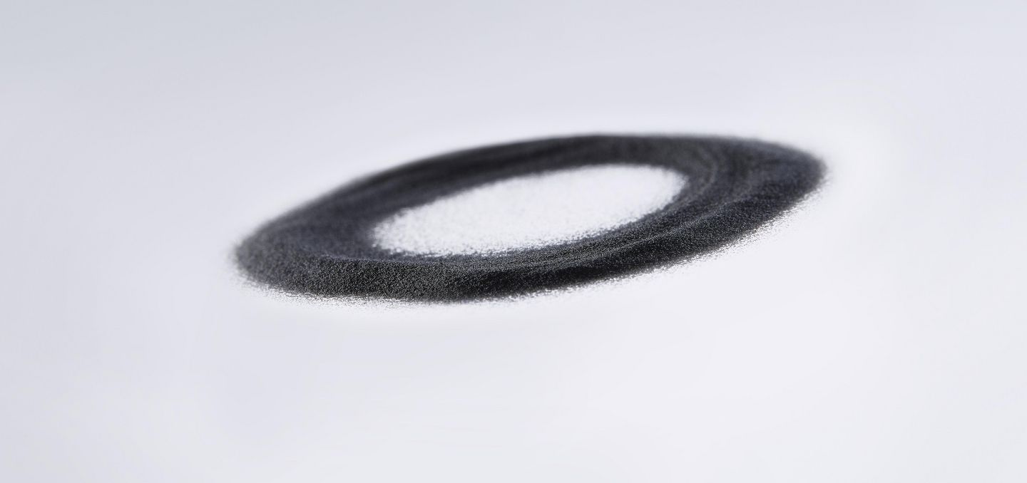

A wide range of metal powders means that TRUMPF can also provide you with the right materials for your TruPrint 3D printing systems. We will gladly provide you with our high-quality metal powders made of aluminum, titanium, cobalt, chrome, nickel-based, or copper alloys, as well as stainless and tool steels, entirely based on your needs. All TRUMPF metal powders are optimized for a perfect LMF process on TruPrint systems, due to the expertise of our material experts. To maintain this quality promise in the long term, we continuously conduct extensive powder and component analyses. The process parameters available for the TruPrint systems were also developed using our TruServices powders. This way, the harmoniously coordinated trio of TRUMPF powders, TRUMPF parameters, and TruPrint systems create the ideal requirements for reliable LMF processes.
Perfectly adapted
Our powders' properties have been optimized specifically for the LMF process on TruPrint systems with TRUMPF parameters.
