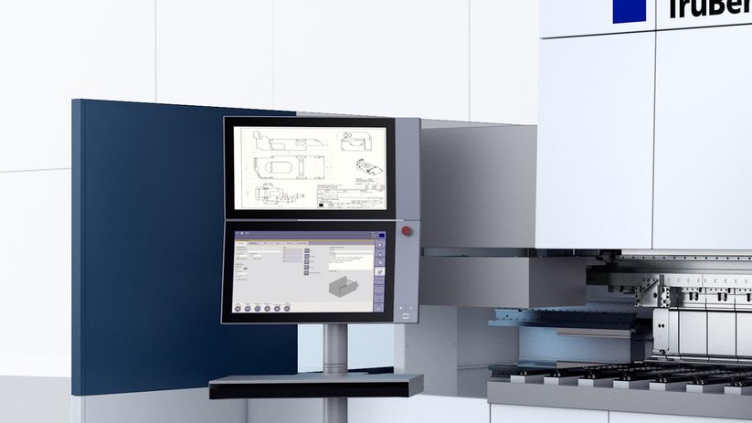

TruBend Center Series 5000, additional screen
Additional monitor
Program parallel to production and produce without paper – the additional monitor on the machine control shows you further information in addition to the required screens and drawings for programming and production. This allows you to program and produce at the same time by using shop floor programming, for example.
