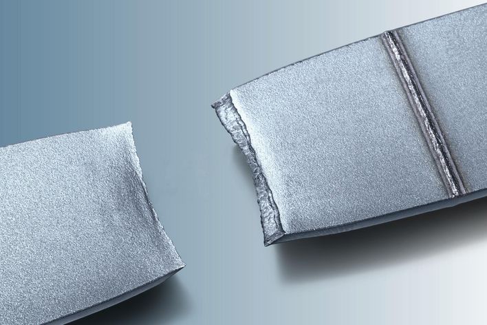

"These thin weld seams do not have enough tensile strength"
Tests in the material testing institute prove: a weld seam created with a laser is as stable as the welded material. Observers are amazed and impressed: if the mating parts are welded with the laser, the material tears – but the seam holds. Conventionally welded sheets invariably tear in the area of the weld seam in tests on the tension test bench at a material testing institute.
