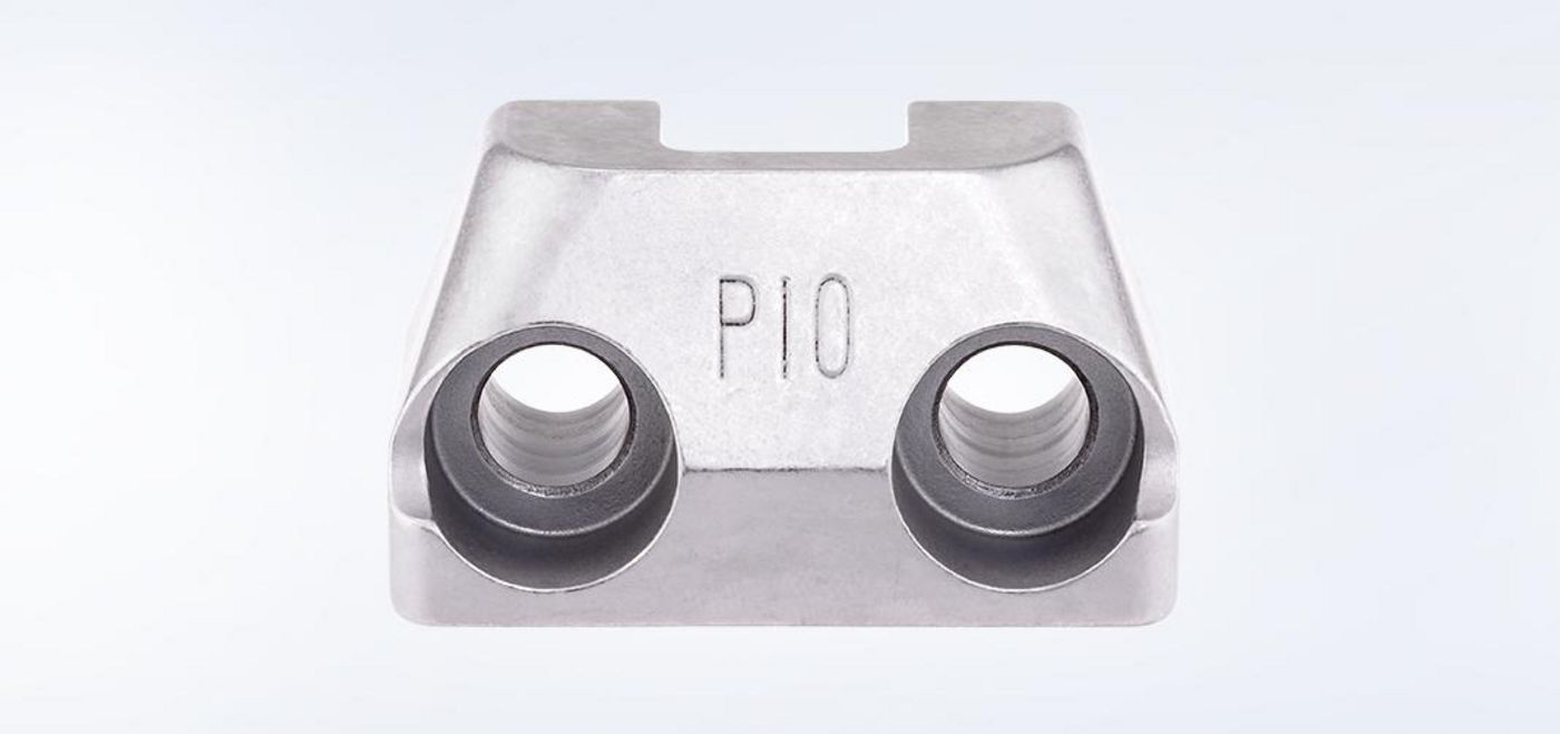

TruTool N 1000, die P10
Die P10
Well-suited for processing profile sheets from 7 - 10 mm
1 unit 1884903

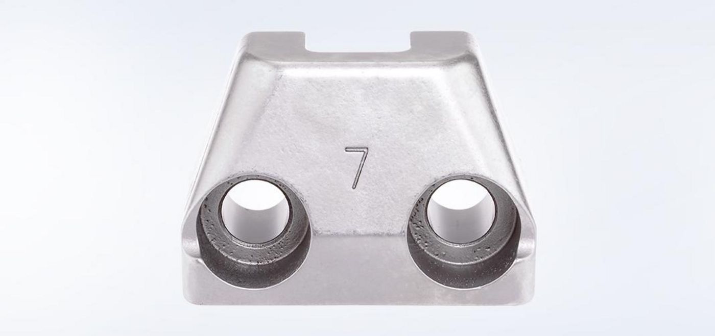

TruTool N 1000, die No. 7
Die No. 7
For processing aluminum, mild steel, and stainless steel 600 N/mm2 from 5 - 7 mm
1 unit 1884905
Set of 2 1264184

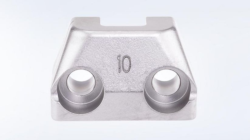

TruTool N 1000, die No. 10
Die No. 10
For processing aluminum and mild steel from 7 - 10 mm
1 unit 1884904
Set of 2 1264177

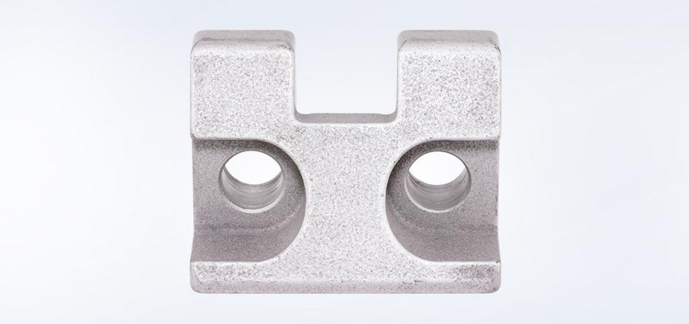

Wearing plate
Protects the die holder against excessive wear
Set of 2 1264375
Set of 5 1264376
