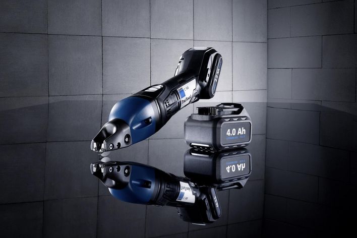

Battery machine for precise cuts
The 10.8 V battery machine, without chip clipper, is particularly well-suited to cutting tasks without chip clipping during the cutting process. For example if you are cutting straight sheets to length or for curved cutting. The 10.8 V battery provides an above-average runtime. The 2 Ah battery cuts around 70 meters in 400 N/mm2 mild steel at a sheet thickness of 0.8 mm. You can even double this service life with the 4 Ah battery.
Machine without chip clipper
For applications where chip clipping is not necessary during the cutting process.
Easy and safe operation
A soft grip ensures a secure hold and enables low-vibration operation.
Ideal for trimming to length
Well-suited for straight, distortion-free cuts and C-L-U profiles.

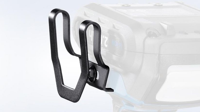

TruTool belt clip
Belt clip
1 unit 1886524

TruTool C 160 Li-ion battery 10.8 V
Maximum sheet thicknesses
Maximum sheet thickness, steel up to 400 N/mm² 1.6 mm
Maximum sheet thickness, steel up to 600 N/mm² 1.2 mm
Maximum sheet thickness, aluminum up to 250 N/mm² 2 mm
Spiral duct steel 400 N/mm² 4 x 0,63 mm
Radii
Smallest radius 90 mm
General
Working Speed 5 m/min - 9 m/min
Idle run stroke rate 4300 RPM
Starting hole diameter 15 mm
Voltage 10.8 V
