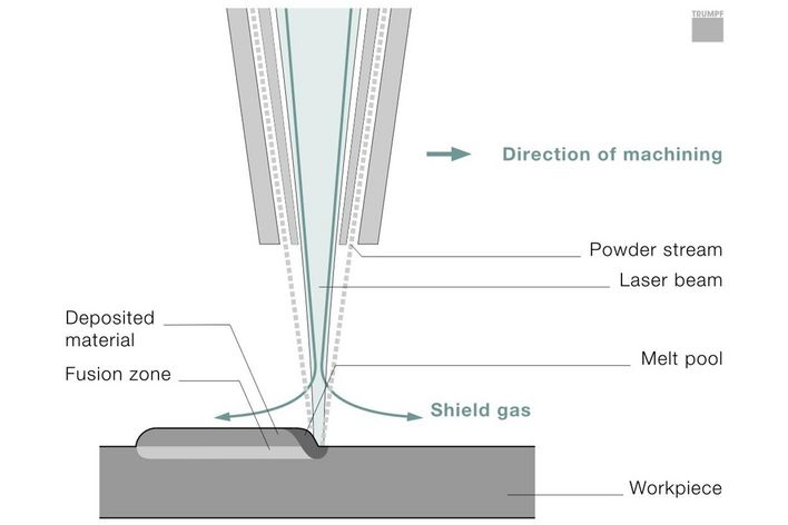

The laser metal deposition process is extremely easy thanks to TRUMPF DepositionLine: You use the laser to create a weld pool on the prepared surface. Powder is guided through the nozzle step by step. As soon as the new material has cooled down, you weld the next layer or start with post-processing.
TRUMPF DepositionLine consists of three essential functional units: the powder feeder, the powder feeder line and the processing optics with the process nozzle.
As a movable unit, the powder feeder is positioned directly next to the laser processing machine. The powder/gas mixture from the individual containers is merged to form one single powder mass stream in the powder feeder and then fed to the process nozzle in a precisely regulated stream. Integrated sensor systems ensure the high quality of the material deposition at all times.
