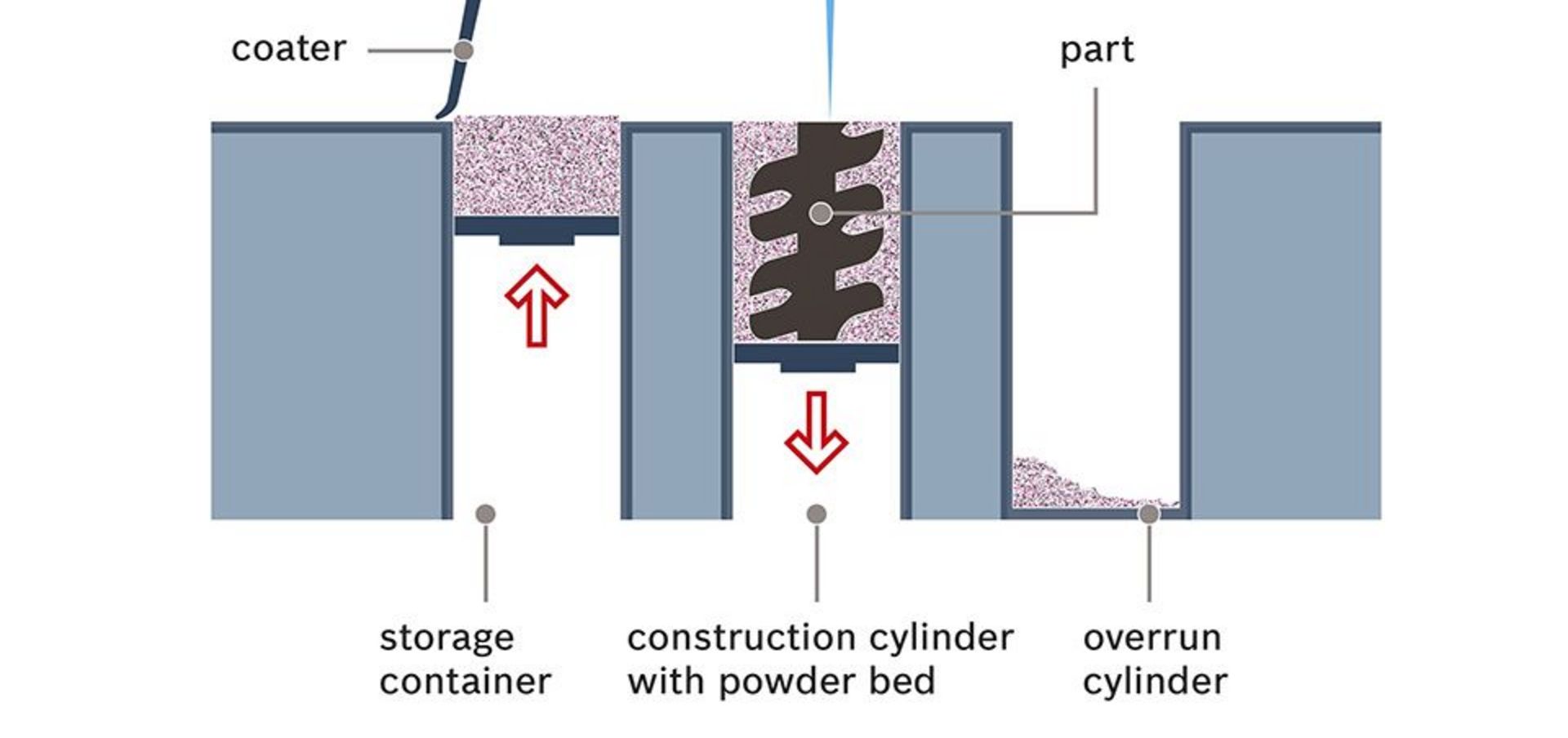

The most widely used process is the powder bed process, also known as Laser Metal Fusion (LMF), Selective Laser Melting (SLM) or Powder Bed Fusion. But how does this technology work? We summarized the most important steps and illustrated them in the picture gallery:
  • Laser metal fusion builds up parts layer by layer in a powder bed. The process takes place in what is called a process chamber.
  • Laser metal fusion essentially works as follows: The supply, construction and overflow cylinders are situated alongside each other in the same axis. A device known as a coater applies powder from the storage cylinder to the construction cylinder.
  • The laser then fuses the first layer of powder into the contours required for the part.
  • Next, the construction cylinder moves downward, depositing any excess powder in the overflow cylinder. This process is repeated until the part is complete.
  • To boost productivity, some 3D printers can work with several lasers at the same time, a feature known as the multi-laser principle.

Functional principle of laser metal fusion.
