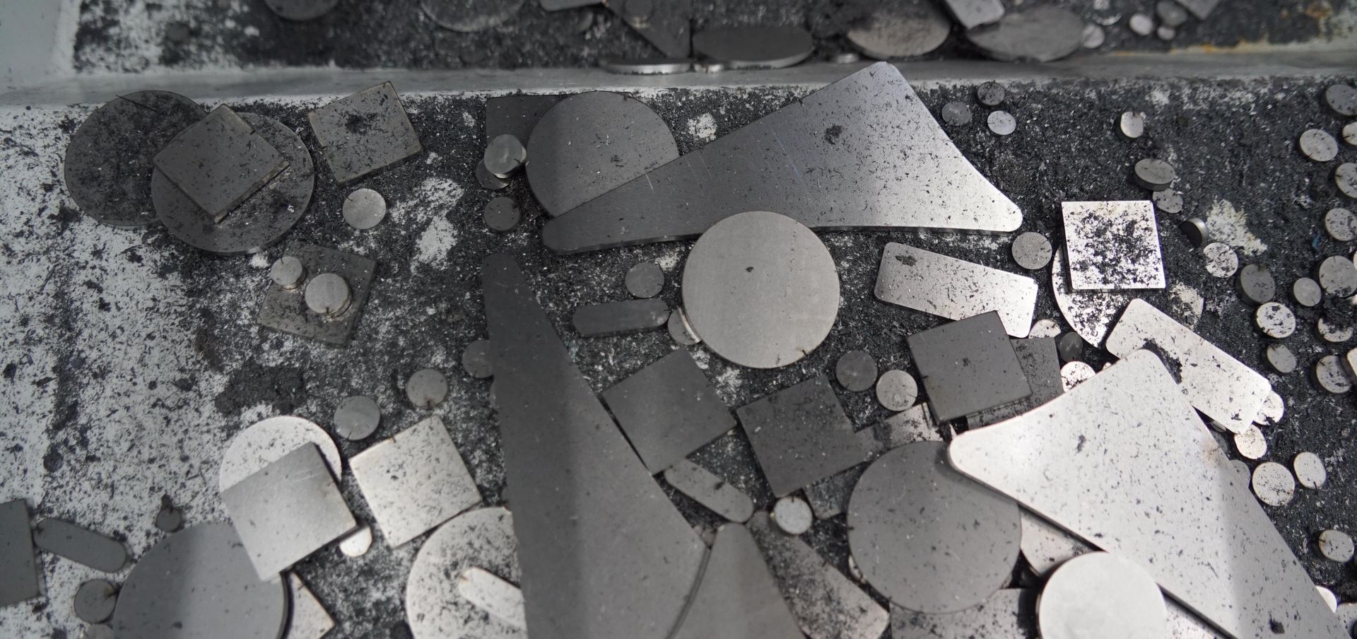

It is hardly surprising that the fully automated laser machine sometimes takes a moment to get hold of the parts it has just cut and successfully remove them. After all, they come in a constantly changing selection of sizes and thicknesses and a bewildering array of different shapes. Tackling this situation requires top-notch jigsaw puzzle skills, but in reverse. The trick here is to constantly find new ways of removing parts from the scrap skeleton.
The secret to success in this case is experience. To maximize their chances of choosing the right strategy for each part, TRUMPF machines rely on an invisible assistant: AI. Even before the cutting process begins, the laser machine knows which method will be most suitable for removing each part.
Of course gaining experience also means making mistakes. If the machine’s 180 pins fail to push the part out of the scrap skeleton at the first attempt, it can autonomously choose to repeat its efforts however many times are necessary, jiggling and shaking the part until it comes loose. And even these efforts rely on a clearly defined strategy, with the machine running through eight different retry procedures until it finally succeeds in removing the part.
