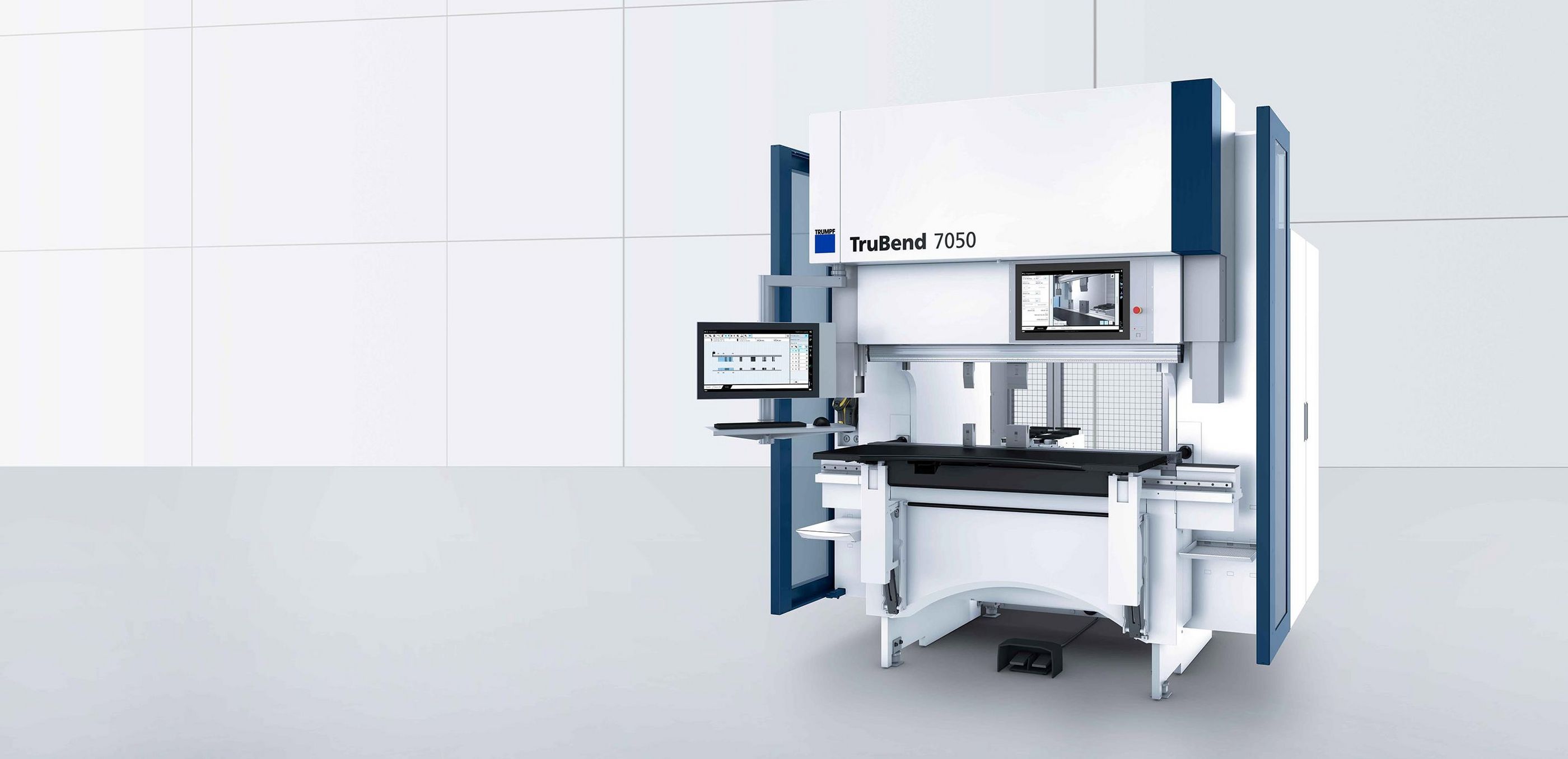

Ergonomic high-speed bending with minimal footprint - for maximum output and comfort
The TruBend Series 7000 is a prime example of man and machine working in perfect harmony. The ergonomic high-speed machine bends small and medium-sized parts under the best working conditions, saving space for every production system. In addition to the high level of ergonomics and user-friendliness, due to the direct drive and our automatic angle measuring system, you achieve a high output at a very high level of quality. Operation sitting down or standing up is comfortable for the operator, and due to BendGuard Automatic, the setup operation is also extremely fast and safe.

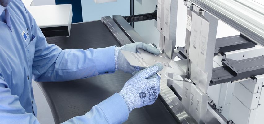

TruBend Series 7000, small part
You can rely on the bending angles being right from the first part.

TruBend 7036
TruBend 7050
Press force 360 kN 500 kN
Bending length 1020 mm 1530 mm
Width between columns 932 mm 1305 mm
Usable open height 295 mm 385 mm
Throat depth 150 mm 250 mm
