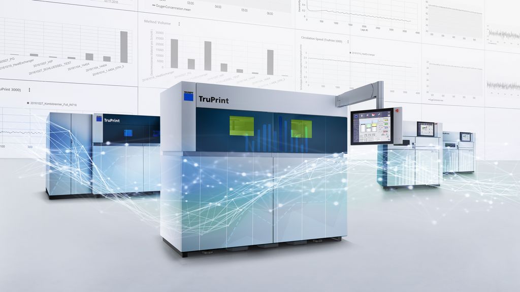

TruPrint monitoring
Increase the efficiency of your production with the intelligent monitoring solutions from TRUMPF. Monitor and analyze your LMF process in the TruPrint machines simply and reliably.
