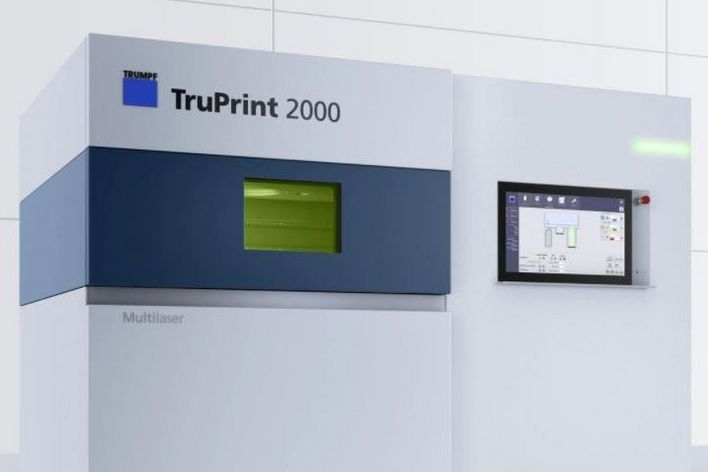

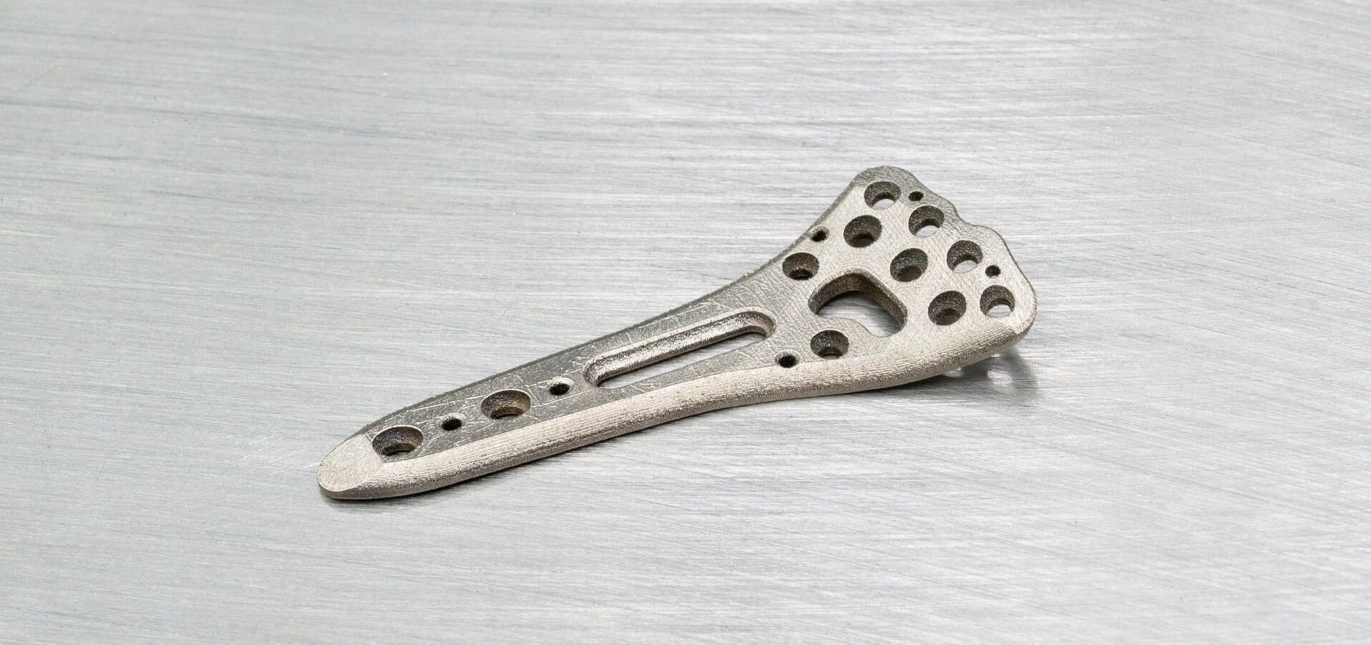

Heraeus Amloy prints radius plates in amorphous metal on the TRUMPF TruPrint 2000. Customized implants from 3D printers will revolutionize medical technology. Valeska Melde, Head of Marketing and Sales at Heraeus Amloy’s, is sure of it.

With aplomb! In collaboration with TRUMPF, we have enhanced the process so that we can work with an exceptionally fine focus and extremely small volumes of molten metal. As such, the heat is quickly conducted away. In turn, this facilitates the critical cooling rate of 200 kelvins per second; an individually customized implant emerges from the powder bed and solidifies with an amorphous ­structure.

This is something that we are currently testing in tandem with partners such as TRUMPF as part of the Clinical Additive Manufacturing for Medical Applications (CAMed) project at the University of Graz. The results are promising, and we are already able to manufacture implants that can then be tested and approved by our clients. So the idea of us printing your bones is already reality.
