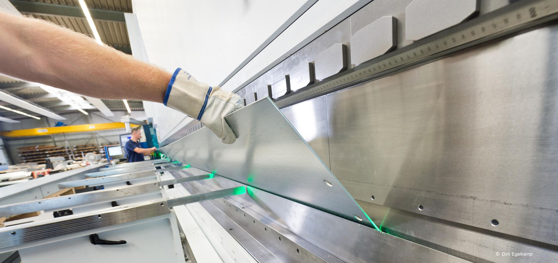

Typical order volumes at Schrag range from a single item up to batches weighing 20 tons. As well as top-quality, most customers also require very short turnaround times. The VarioPress 400 at Schrag has a higher-power motor and an additional height-adjustable axis that allows users to bend Z profiles.
