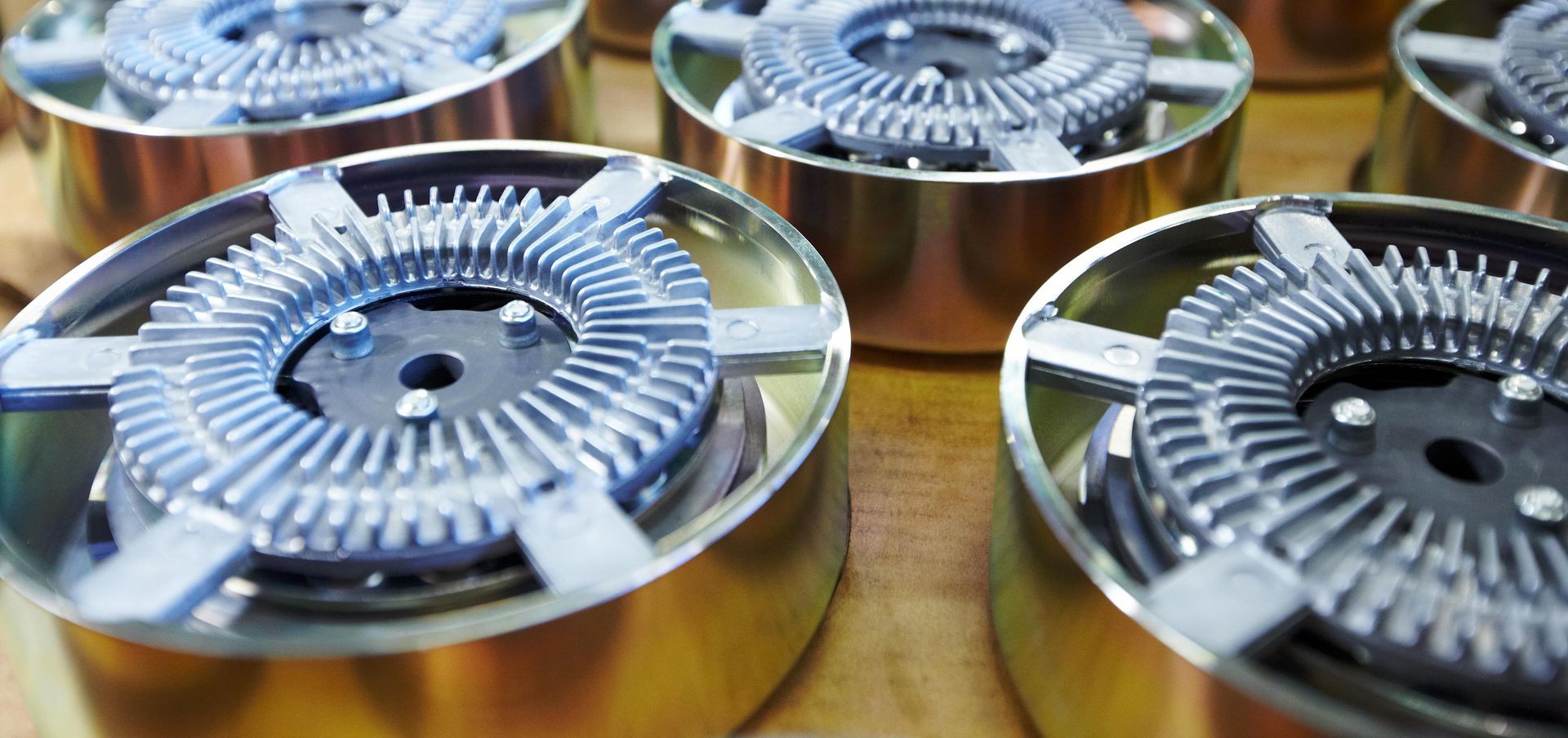

LICOS Trucktec manufactures unique water pump clutches for trucks. In recognition of this design, the firm was awarded the Innovation Prize by the state of Baden-Württemberg. “Our clutch makes it possible to regulate the speed of the water pump to meet the engine’s needs, bringing about a one percent fuel savings. And on average that works out to 500 liters per vehicle per year,” explains Franz Biegert, plant manager and supply chain head at LICOS. Demand among both domestic and foreign truck builders is strong. The company now turns out about 120,000 units per year. Their manufacture demands quality and safety, of course, but trouble-free processes are of decisive importance.
It seems as though the TruLaser Cell 3000 was built to meet these needs. The system was installed at the end of 2011 and has held up even under the most extreme conditions. “Our water pump clutches have logged zero PPM for field failures! That’s a great achievement and demonstrates the system’s process reliability,” Biegert explains. This background and the machine’s flexibility have made him a believer. “The first few months convinced us of the laser cell’s superior cutting performance. Now we are also using it to weld our water pump clutch,” he explains.

The specific geometry of the product requires that it be manufactured in two stages. In the past, LICOS welded the two rotating parts on a TruLaser 7040 made by TRUMPF. “That worked just fine, but we had to transfer the parts from one line to another,” Franz Biegert explains. “The TruLaser Cell, despite its tall profile, is extremely compact, with a footprint of barely 16 square meters. That includes the peripheral components such as the vapor exhaust and the beam source itself. This makes it possible to simply place it between the lathes and makes for a decisive simplification in the process flow.”

The LICOS clutch has won the Baden-Württemberg Innovation Award for its fuel-saving capabilities.
