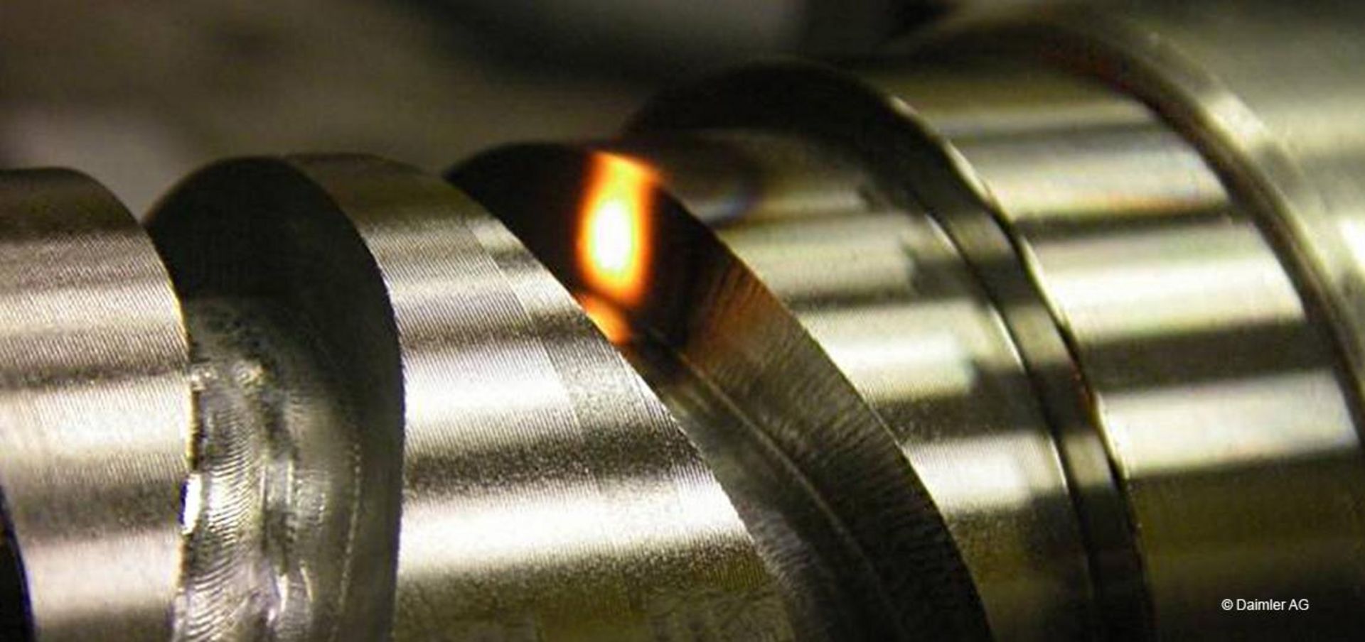

In numerous experiments, the experts worked out the best parameters for laser hardening at different points on the component’s surface.
