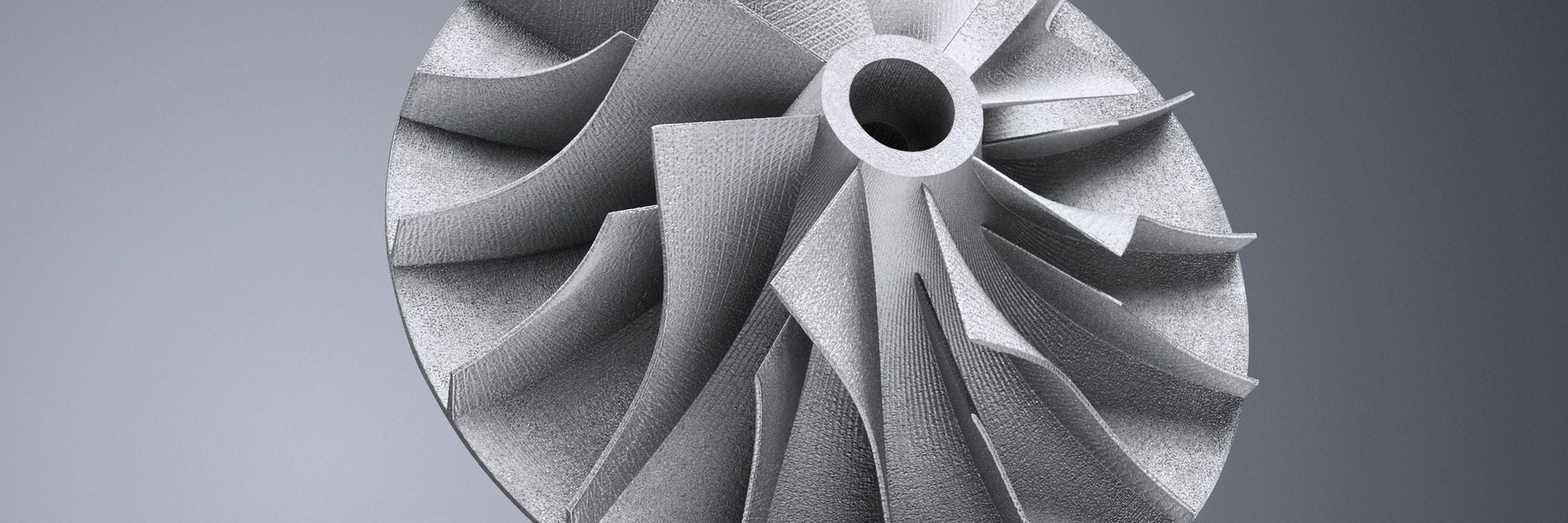

Prototype: The impeller component is a prototype from the Powertrain Development Department. This component geometry was tested by Volkswagen AG to optimize flow behavior within the motor.
