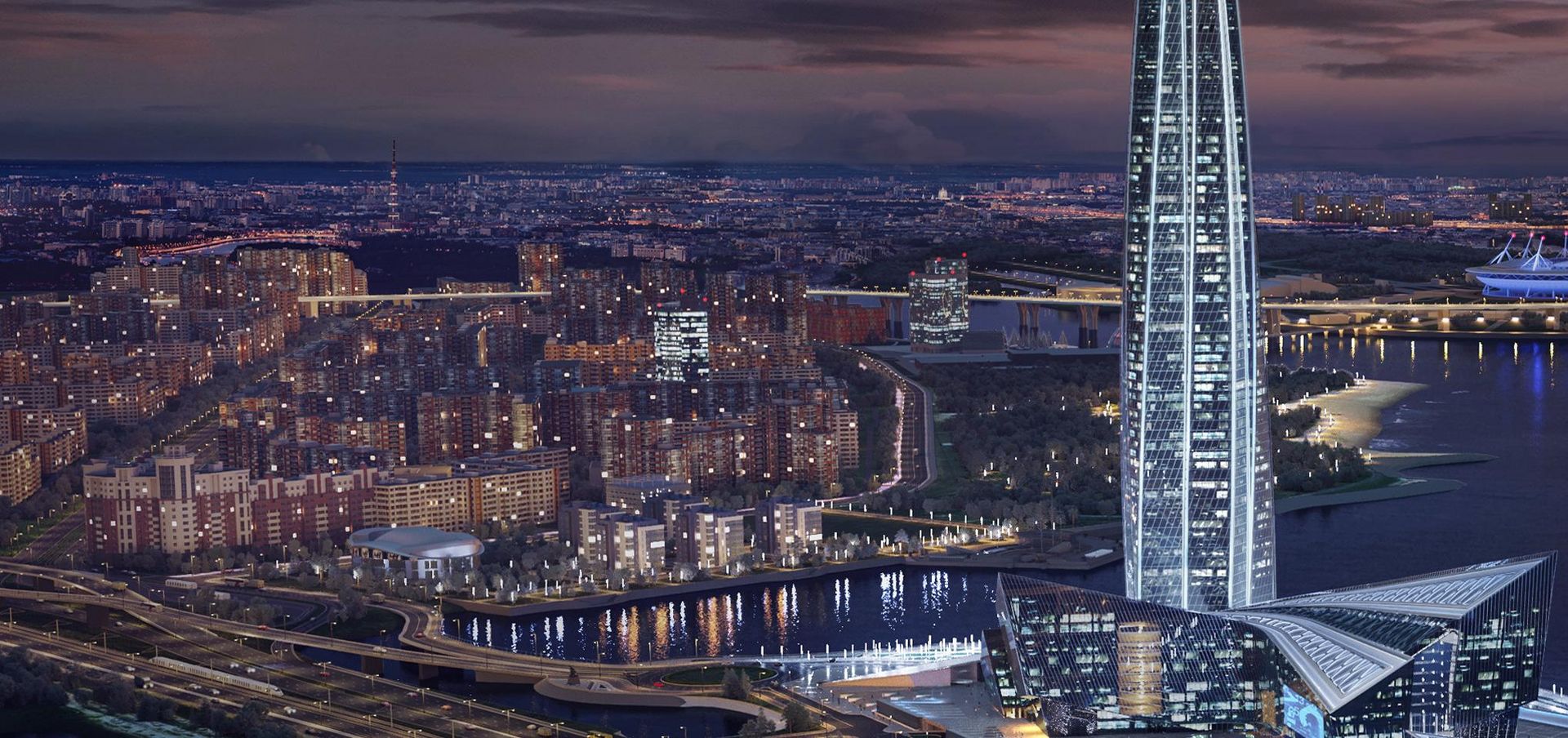

Lakhta Center in St. Petersburg, Russland. (Quelle: TRUMPF)

Europe’s highest building was processed with a TRUMPF Laser
Standing 462 meters tall and completed in 2018, the Lakhta Center in Saint Petersburg (see stage image), which is the headquarters of gas giant Gazprom, is the tallest building in Europe. The design of the top 22 meters would have been impossible without a laser. It was fabricated by the company Edelstahl-Mechanik GmbH, which is based in Göppingen, Germany. “It was crazy,” says managing director Josef Eisele, referring to the tight deadline of just four months from order placement to delivery. With the tower spiraling its way into the sky like a drill bit, every sheet of the outer cladding is different. The tapered and twisted stainless steel parts, up to 60 millimeters thick, were all 3D laser cut using TRUMPF lasers. And that wasn’t the only time the laser was put to use for the Lakhta Center skyscraper: to prevent icicles from turn - ing into potentially deadly projectiles, the tower’s metal panels are heated from the inside. Edelstahl-Mechanik’s employees also used the cutting laser to mark the positions of the bolts that hold these vital heaters in place, saving themselves the subsequent effort of mark - ing them out with a stencil. “Without laser technology, it would have been impossible to get all that done in such a short time with just 100 people on the job,” says Eisele.
