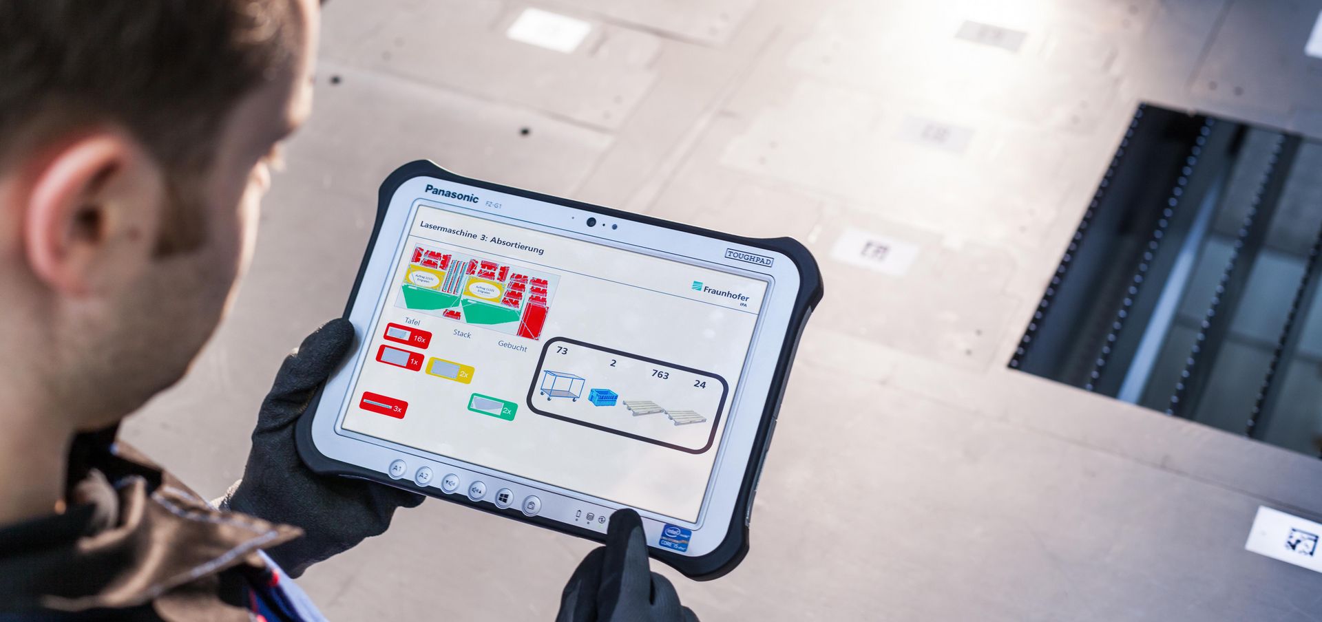

Schneider: Absolutely. We’ve worked with TRUMPF to develop and build a range of demon­stration setups that represent the various technologies used in sheet metal processing. For example, we can show visitors a sorting table for a laser processing machine, where we test how long it takes a worker to sort the metal sheets.
The simulations we run in this test environment reveal how supporting measures such as a new tool or an automated process can have an effect on the overall production process. Visitors get a chance to see exactly what happens when the sorting process goes faster and what impact that has – not just on the machine, but also on the subsequent process steps. They can see whether materials are piling up next to a machine because the previous batch isn’t finished. And they can see what you can do to prevent that happening so that your production process runs more efficiently and smoothly.

Wahl: We drew on the expert knowledge we had accumulated in our numerous visits to customers worldwide, but we also spent a day each at 25 different production sites run by customers we chose as a representative sample. Based on our findings, we were able to create several examples of production systems that fairly accurately reflect what many customers experience.
Schneider: These production systems form the basis for simulations that mirror real-life sheet metal processing very accurately. And the 3D visualization of the simulations makes Industry 4.0 and its advantages and opportunities easier to grasp and appreciate.
