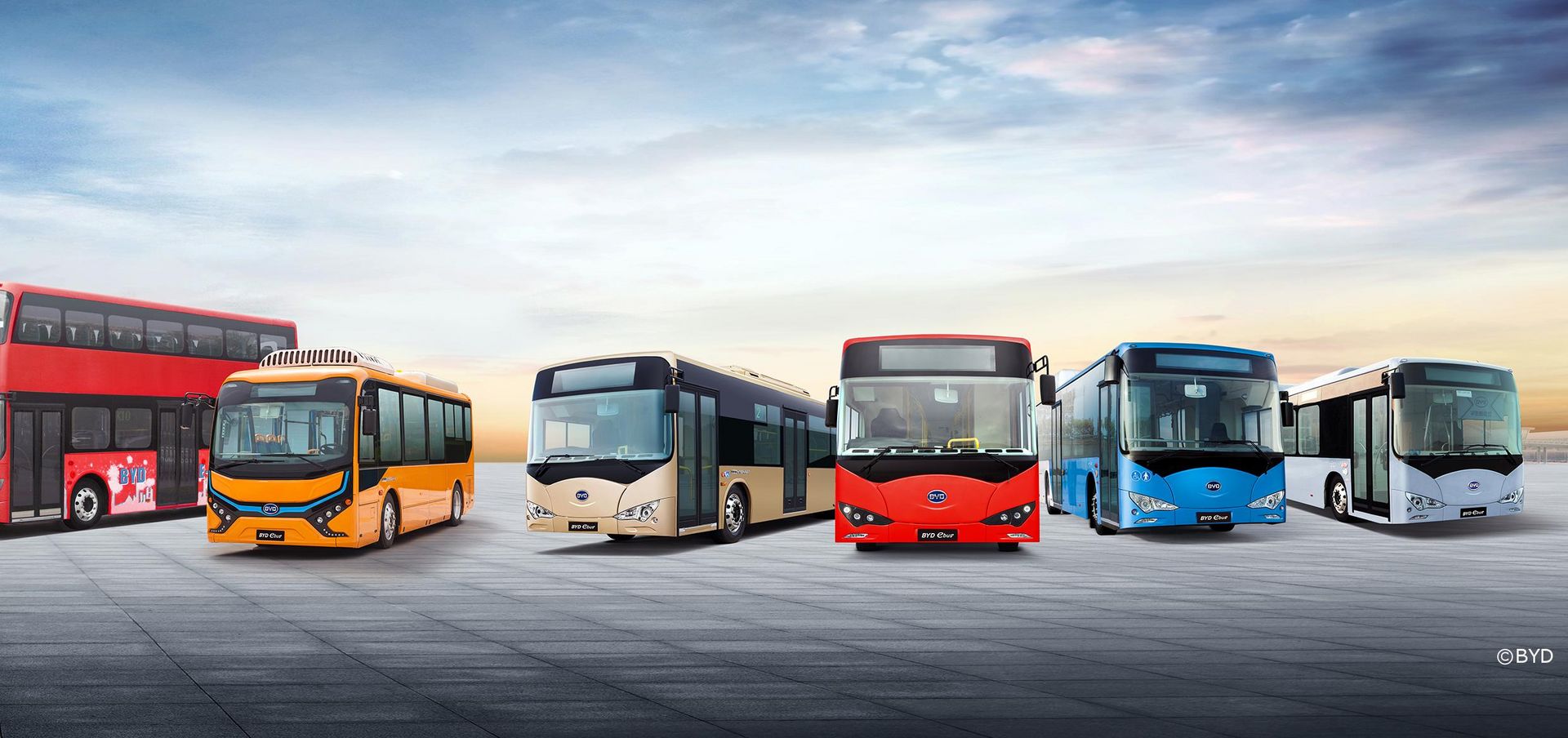

Since 2013 BYD´s electric buses like this one drive on London´s streets. In October 2015 the world´s first electric doubledecker bus entered Service. (Images: BYD)
BYD developed its own iron phosphate battery for the electric busses. They are safer than the more common lithium-ion batteries. (Images: BYD)
BYD
The first electric double-decker bus designed and built by BYD at its presentation in London. (Images: BYD)
