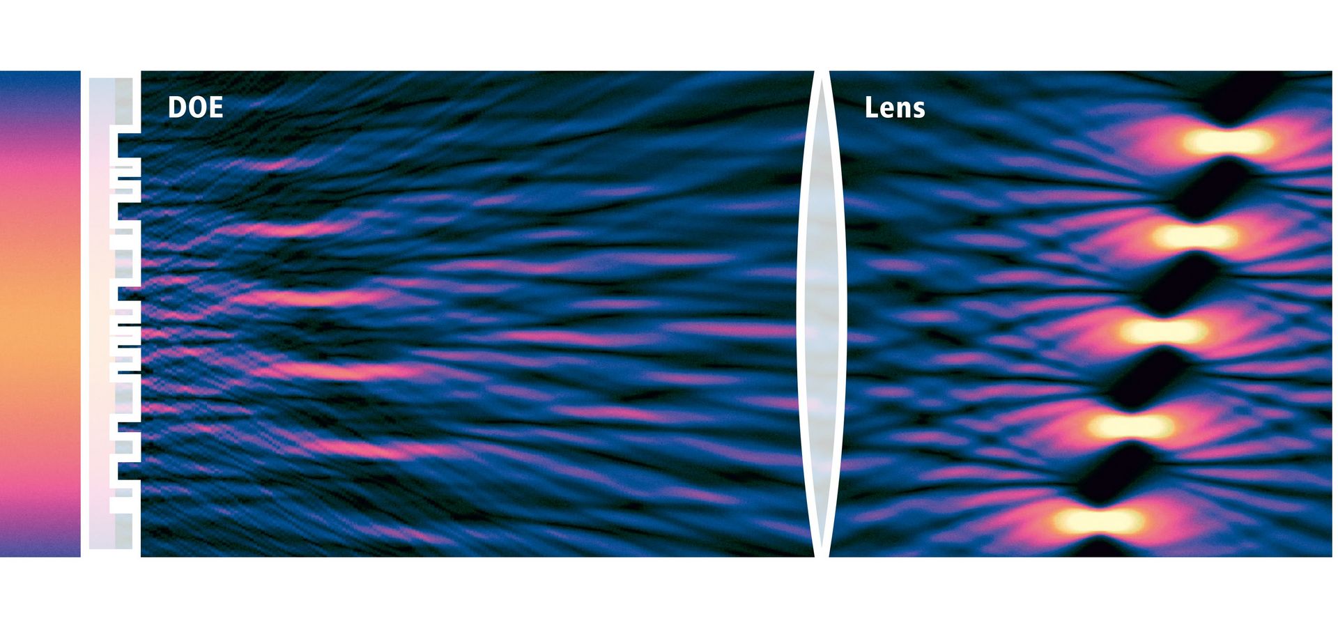

Simulated effect of a diffractive optical element (DOE): in this example, the system generates six volume-distributed focus zones on the workpiece from a single beam using targeted aberration of the laser light. The different colors show the intensity distribution. (picture: TRUMPF)
A thousand times more efficient
Targeted aberration of the laser beam enables us to tailor the focus to the requirements of a particular application. In glass cutting, for example, we can extend the focus along the direction of propagation in order to simultaneously change the structure of the material throughout the entire volume of the glass. Another option is to use diffractive optical elements (DOEs) to accelerate light. This method causes the focus to bend at a certain angle, so it looks like the letter C, for example. Laser beams with a C-shaped focus can then be used during cutting to give display glass the curved edges it needs without any reworking. Other DOEs split the focus and distribute it freely in space within a given volume. In TRUMPF's advanced engineering department, we have already split a laser beam into 133 foci and freely distributed them in a different form within a volume of one cubic millimeter. This has enabled us to tap into new opportunities and efficiencies in the microprocessing realm.
On this basis, it is perfectly conceivable that we could distribute them in other volumes, too, with the number of foci ascending to the hundreds of thousands. Metalworking applications could benefit from rectangular functions (flat-top distribution), which generate homogeneous intensity over a certain width, while the intensity outside the rectangle is simply zero. Instead of producing surface structures pulse by pulse, a focus with flat-top distribution can ablate the material in a single shot. The efficiency gains are huge: depending on the laser you're using, diffractive beam splitting can divide each focal point of the beam into between 50 and 1,000 foci without any loss of power, thereby increasing the processing throughput by a factor of 50 or 1,000, respectively.
