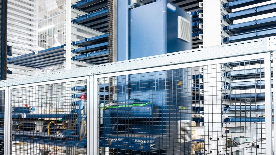

Brightly lit, neat and tidy, the production facility echoes to the staccato sound of the punching machines and the steady humming and whirring of the SheetMaster. An operator strolls up to the machine, glances at the control screen and continues on his way. Behind the machine, a STOPA storage system towers up to the ceiling. Almost seven meters high and some 65 meters long, it provides 582 storage bays for large-format metal sheets and a total storage capacity of 1,750 metric tons. The storage and retrieval machine whizzes back and forth with barely a sound, one minute removing empty pallets and transporting them by rail or trolley to a machine, the next inserting pallets of semi-finished and finished parts into vacant slots. Things are quieter on the other side of the STOPA storage system where two automatic bending machines are hard at work, both of which are also receive their raw materials from the SRM. Productivity on both sides is high, with everything running smoothly and fully automatically. But it wasn’t always like this.

The storage and retrieval machine is the key to efficient sheet metal processing, ensuring that all the necessary materials are supplied to the connected machines and then returned to storage. The SRM is mounted on rails in the middle of the storage system, allowing it to travel at tremendous speed both vertically and horizontally to reach any storage bay. The TRUMPF project planners have to take into account the customer’s specific production requirements as well as minimizing both the distances the SRM has to travel and the time each machine has to spend waiting for materials.

The storage and retrieval machine is mounted on rails in the middle of the storage system, allowing it to travel at tremendous speed both vertically and horizontally.
