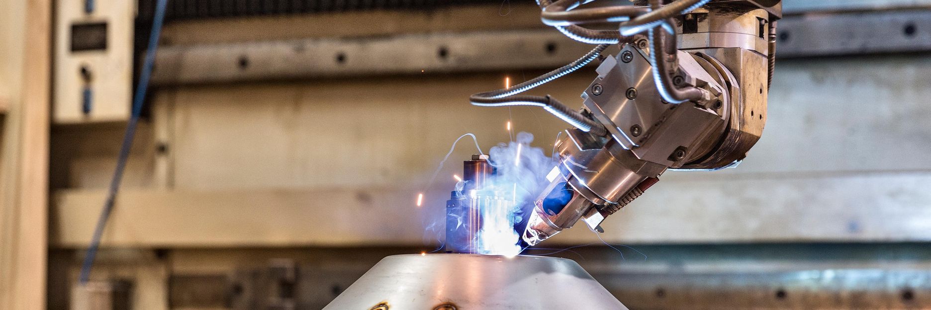

Once he’s reached the laser system, he introduces his current project. “Here, we’re in the process of manufacturing an impeller.” However, there is not much to see. Laser optics move to and fro – and only on closer inspection can we tell that gradually, layer by layer, an object is emerging. “LMD,” says D’Alonzo in a word.
Data to forms
The abbreviation “LMD” stands for “laser metal deposition”, also known as laser cladding; it is the name given to a process in which metal powder and laser light are used to manufacture workpieces. In this process, a laser generates a melt pool on a base structure and simultaneously causes powder delivered via nozzles to be fused into beads.
ELFIM is using a nickel alloy powder for the impeller.
In combination with a powder feeder, the Lasercell 1005 from TRUMPF is also highly suitable for laser metal deposition.

“Strictly speaking, LMD is actually nothing new. It’s a process that has been used for many years now for repairs and coatings. However, we decided to use the process for manufacturing complete components – as is the case with this impeller here.”

D’Alonzo leads us back into the production facility. There, the first impeller blade is now finished. “If we had used the conventional process, we would have had to mill the blade from a large block of metal – and 70 percent of the material would have then simply been thrown away.”
D’Alonzo runs his hand over the impeller blade and points out another advantage: “We just wouldn’t have been able to create this geometric shape with a milling machine. However, the special curvature enables the impeller to handle 50 percent more volume.” Since the powder is fed through nozzles coaxial to the laser beam, it is possible in principle to expand forms in any direction.
